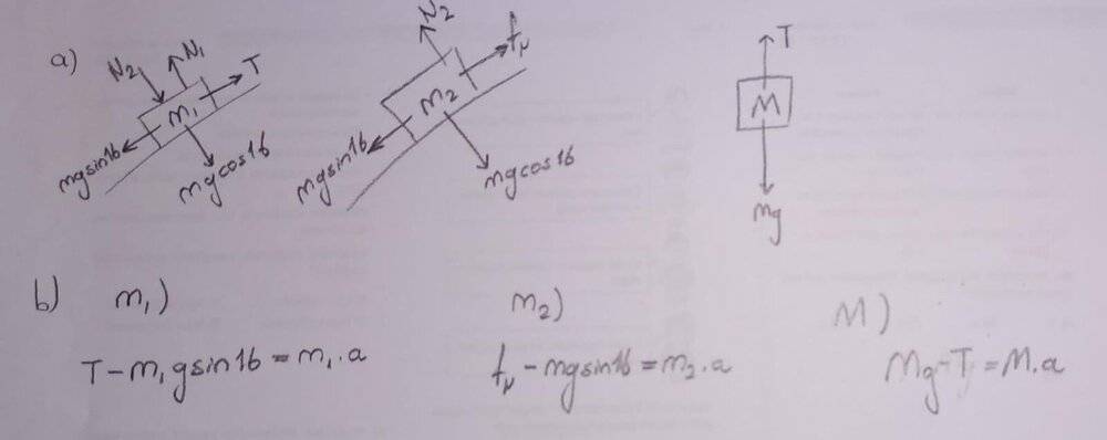

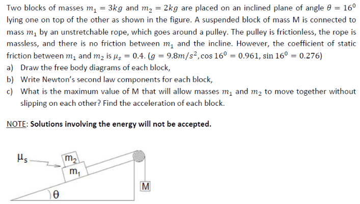

I did part a and part b but stuck in part c. Could you help me? (Part a and b attached.)

mustafamistik said:
Homework Statement:: It's not Homework.
Relevant Equations:: F=m*a
Please post your answers to parts a and b.
I edited. You can help even if you tell me a solution way. Cause I don't even know what to do .
You are missing a force on m1.
Is it Friction force ?
Yes.

haruspex said:
Yes.
Thanks. Could you give a hint for part c?
Think about the maximum acceleration that is possible with the given coefficient of friction.
friction-m*g*sin(16)=m*a
Is this equation true ?
It's hard to make sense of that out of context. Please describe what you are trying to say with that equation.
This equation to find maximum acceleration. (m2*g*cos(16)* μ) -(m2*g*sin(16))=m2*a (F=ma)
Okay, and the mass cancels out, of course.
What is the relationship between the large mass, ##M##, and the acceleration of ##m_2##?
I think,
##T=M*g ##
##M*g - (m_1+m_2)*sin(16)=(m_1+m_2)*a##
The acceleration above is the acceleration of the ##m_1 and m_2## since, acceleration of ##m_1 and m_2## must be equal.
But maximum acceleration is,
(m_2*cos(16)* μ )-(m_2*sin(16) )=m_2 * a_max
a_max=cos(16)* μ -sin(16)
Am i right?
