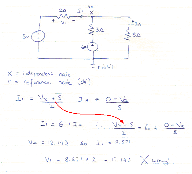

Hey PF I need your help...again!
Use Node Voltage Analysis to solve the unknowns in thishttps://dl.dropboxusercontent.com/u/53341615/Question.png
Im quite confused and have had many attempts, https://dl.dropboxusercontent.com/u/53341615/My%20attempt.png is my latest attempt. I am sure I am doing something very wrong.
If anyone would be able to point out my mistakes/show me the right direction that would be much appreciated. Thanks.
Likes 1 person
! that's embarassing. Thankyou very much haha.
