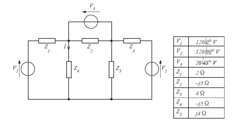

I have a circuit which I have a current through labelled I on circuit. I have -9.18 +j17.31. we agreed this was correct. I have a node analysis problem but cannot find the correct answer. I feel my method and my maths may be off but would like some advice if possible please.[/B]
I have included all my workings and circuit below. There may be a lot wrong but I thought I was doing well. I am hoping for some pointers please. Thanks again to the people who have helped before.[/B]
My attempt is included.[/B]

At the end of your work where you have V30 = V20 - V3, following that you have two values in polar coordinates. You have added both the magnitude and the angle of those two numbers. You can't do that. If you want to add two complex numbers they should be in rectangular coordinates and you add the two parts. If you want to multiply two complex numbers, you express them in polar coordinates and multiply the magnitudes, add the angles.
Following all that, you need to substitute the expression V20 - V3 for V30. You haven't done that correctly. Check your work.

You showed some work in post #1. Redo that part near the end, following V30 = V20 - V3, fixing the errors I described in post #3.

Your first attempt showed a nodal analysis. You second attempt shows a loop analysis. Your second attempt is wrong if you're trying to correct errors in a nodal analysis.

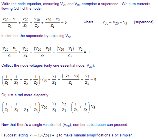

I really can't see what you are doing here. What is 60+I30 ? Where do you use V1 and V2? For the node analysis you need to identify unknown voltages with nodes and then use KCL in those nodes to find the unknown voltages. I Can't see how you do this. Try to use a bit more text in your workings, to explain what you are doing.
For node analysis there is really only one unknown voltage, so you should be able to solve for it by using Kirchhoff's current rule only once.
If you have two nodes separated by a voltage source it's hard to find the current through the voltage source, but you don't have to.
You can draw a box around V3, Z2, and the two nodes to the left and right of them. The sum of all outgoing currents for this box should be 0.

I think you need to throw that out. If you assume one unknown voltage in your circuit, you should be able to work out all currents in the circuit as , and then use KCL to work out the unknown voltage. Don't try to fill in complex numbers too early, or nobody will understand anymore what is meant.

I have to say that I'm not a big fan of plugging in numbers until the smoke has cleared from the essential algebra. It's difficult to follow the provenance of a numeric value back through a derivation if you're looking for possible errors. Variables are unique and easily tracked.
Because this problem has been thoroughly thrashed out in another thread, with complete solutions attained, I'll take the liberty of providing a summary of what I consider to be a good approach for this portion of the overall problem (note that if no such solutions were arrived at previously this would be a forum rules violation!). You've already done much of the same work, but working with numbers makes it tedious to track down the details where things go off the rails. Here's a purely algebraic version of what you've attempted in your recent attempt:

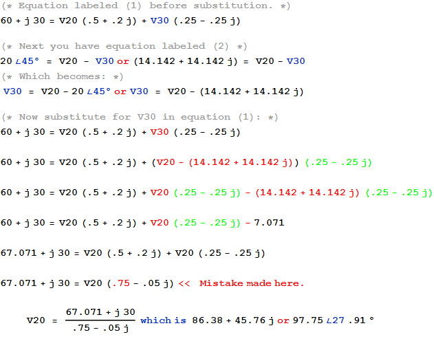

Here is the substitution of your equation (2) into equation (1) in the kind of detail you should have shown. You just haven't shown enough detail to make it easy to follow what you did.
At the point where you have "(1) + (2) =" you made a simple arithmetic mistake. You should have added .5 and .25 and gotten .75, but you made a mistake.

hope my answer comes out as -9.18 +j17.31 like my spread sheet answer from first attemp.
wow it worked thanks you guys your great. answers dead on. As you may have guessed i am doing a distance learning course and have no teachers to help so you guys have been wonder full. the material i have is also lame and my confidence has been crushed a bit. thanks and you guys and happy Christmas to all. i will study hard now for my next assignments on three phase.
