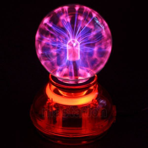

ee-Shipping-Red-Induction-LED-Sound-Magic-Lamp-Plasma-Ball-Static-Ball-Magic-Ball-Induction-Ball.jpg
DC? :smile:
sophiecentaur said:
DC? :smile:
Yes DC. Put a DC charged wire near the bulb and see distortions is the patterns.
Good thinking young man. Sensitivity and calibration should be soluble.
