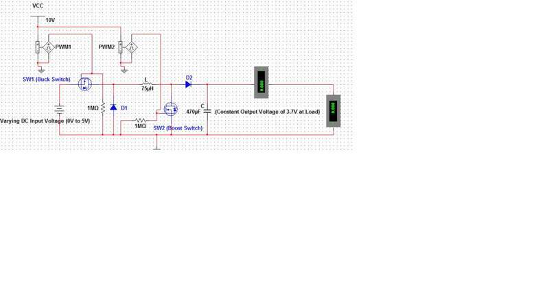

Function of the Circuit:
• Provide a constant voltage of 3.7V at the load for battery charging when there is an input ranging from 0V to 5V.
• When SW1 driven by PWM 1 and SW2 is always OFF, the device will work in Buck Mode. That is if input voltage goes above 3.7V.
• When SW1 is always ON and SW2 is driven by PWM 2, the device will work in Boost Mode. That is if input voltage is below 3.7V.
Question:
How to create a feedback system at the output which will cause the output to stay constant at 3.7V?
• The circuit have to boost the voltage to 3.7V if the voltage at the input is below 3.7 V
• The circuit have to buck the voltage to 3.7V if the voltage at the input is above 3.7V
Note: The circuit is attached in the thread.
  • Schematic of a buck-boost converter with two MOSFET switches labelled SW1 (Buck Switch) and SW2 (Boost Switch), an inductor of 75µH, diode D2, a 470µF output capacitor, a varying DC input labelled 0V to 5V, and a load labelled Constant Output Voltage of 3.7V at Load.
The usual solution to this situation is to first boost to say +12V, then buck that to +3.7V.
As it is required to supply 3.7V output even when there is no input, you'll be deriving full power from another source under some conditions.

Since this is your schoolwork problem, you need to show a fair amount of initial effort, before we can be of tutorial help. Can you show us some techniques that can be used for this problem?
