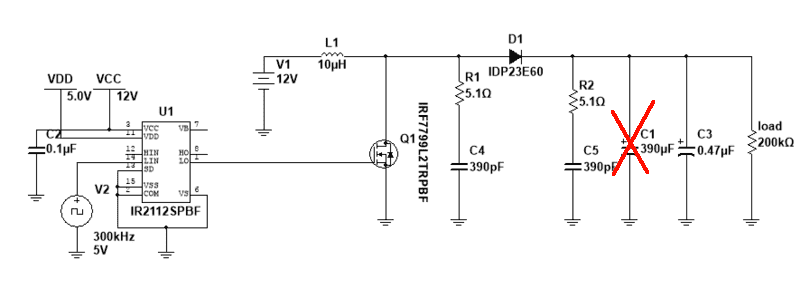

switching frequency is 300khz..
i am attaching boost circuit schematic.
yes sir simulated in multisim.
Are you measuring a real system, or is this all simulation?
While the switch MOSFET is closed, current increases in the inductor.
When the switch opens, the inductor delivers that current to the output.
When converting from 12 V to 200 V you can expect a duty cycle with 95% switch on, with 5% boost during off. If that is not the case, I would look at the inductance value, series resistance and saturation.
1. Plotting duty cycle against output voltage assumes a fixed load current. But the current is voltage dependent. Open loop operation is not used for flyback boost converters, so why do you model it ?
2. For big voltage ratios, a transformer would be used in place of the inductor. That can reduce peak currents on the supply and load.
3. If the output load goes open circuit, the output capacitors will be damaged by overvoltage.
4. You need a controller with some feedback of output voltage to the regulator. That controller should limit the inductor current when there is a short circuit.
What type of controller are you contemplating ?

Sir i am testing real time system.
As you said for converting 12 v to 200v i need duty cycle should be high.
So insted of giving 12v i am giving 24v. Then also at 20-40% there is no change in voltage. After that sudden increase is happening.
The capacitor what i am using has rating of 400v. I used all components which are high rated for testing.
Sir i didn't inderstand the 4th point you are explained. Please explain more about this

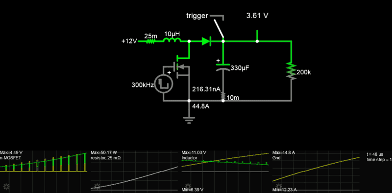

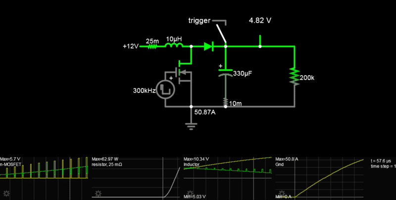

The reason for the clustering of output voltages for different duty-cycles is related to the mode of operation, influenced by the way current flows in the simulated inductor. If I place a diode, D1, in series with the inductor and supply, it performs without the clustering, and with different output voltages.
Percentage duty-cycle for traces are labelled in the same colour.
With D1
Without D1
Is that from the reverse recovery of D2? The simplest models say no current can flow that way. It seems it should be a pretty benign (soft) turn off for D2 in DCM mode.
Or maybe something about increased switching losses with the drain capacitance. Maybe quasi-resonant style? That kind of makes my brain hurt to figure out.
I do not yet know what mode it is, but I have managed to duplicate a clustered output simulation similar to the OP, with what I think is the simplest parameterised circuit in LTspice.
It does appear to be a bizarre π resonance involving the supply, inductor and the switch, but due to my other priorities, it will have to wait for the weekend before I will know if it is "too ideal" a model, or some real possibility. That is, unless someone else solves it first.
Yes, that's guess too, unless you have a REALLY slow (or schottky) diode for D2. But I don't think it's bizarre. It is normal in SMPS when conduction stops for nodes to show LC style (parasitic) oscillations. But I don't understand how that consumes more energy than the non-oscillatory case of the drain voltage being left high and then dissipated resistively during the FET turn on. As I said it makes my brain hurt... or, maybe I'm just lazy.

Hello,
i am designing a boost converter which will provide output of more than 200v (input is 12). since i need to drive piezo load. i already designed and tested the circuit , but the output of the circuit is not expected as calculation. (not used feedback).
i am using this equation to calculate the output voltage
Vout/Vin= 1/(1-D) ---- (1)
i just randomly choose the value of components which has ratings of 400v and 30A. cuz i dont know exactly how to calculate value of each component.
i choose the value of components as
diode with rating of 400v and high current.
capacitor 390uh
mosfet 400v with 30A rating--( using ir2110 to drive the gate)
inductor as 10uh.
switching frequency is 300khz( tested withn 200khz and also with 500khz -- getting random outputs.).
when i am testing the circuit the circuit works and boosts the voltage for higher duty cycle, but not the result as i calculted from equation 1.
can anyone tell me what is the fault in my circuit, and how to correct it.'
can any one give me practical boost converter graph so that i can relate output of my current design.
is it necessary to use the voltage feedback to boost converter.
i dont any any clue, give any reference document, please help.
thank you.
We need to know what circuit you are using. Please attach the circuit to a post.
Both variation of duty cycle, and variation of load, will determine output voltage.
Voltage feedback is highly recommended.
Have you tried to simulate the converter with LTspice?
this the circuit i am using. please dont go with the part numbers of mosfet and diode, what i am using is different from the schematic.
inductor- SRP2313AA-100M
mosfet - STP45N40DM2AG
diode - DPG30I400HA
my load has resistance of 200kohms and 3uf. i simulated the circuit with multisim not in ltspice.
sir in simulation i am getting the output voltage as caluclted using equation 1. but in real time results are not even close.
for ex, at 30% duty my simultion output will be26.3 v but practically iam getting 100v.
