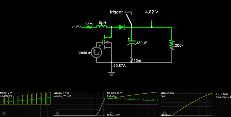

FET modelled for 38 mΩ , DCR and low ESR shown .> 50 A @ 57 us with a 5A inductor rising about 1A per us.

Yes, a good point. The high load resistance may make you think there will be voltage at the output to discharge the inductor. But with really big output caps. the voltage may not build up quickly enough to keep the inductor current low. This can also be addressed by a soft-start feature in the controller, which is common.
This is a good argument for a current mode controller. In any case, I have never designed a SMPS that didn't have some flavor of overcurrent protection for the switches.
Also good to point out that startup and steady-state operation must be considered separately.

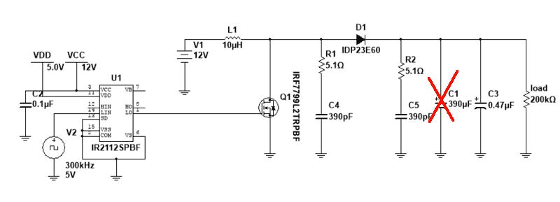

I hope you realized 390 uF was deleted for a good reason.
What is the real piezo load in nF, ohms?

This design is pointless until you define the load in watts and nF load capacitance, for which all piezo's are rated.
Diode capacitance will also impact results. As always, better design specs. results in a better design.

sir the piezo has 1uf capacitence and 200k ohm resistance, i dont know exactly how much power is required to actuate this, since i dont know how much current it takes.

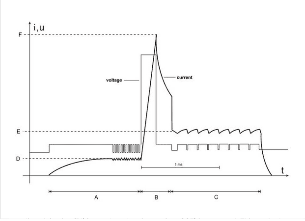

How many injectors sharing the same HV?
You must define all the parameters of the injector pulses before you can define all the supply parameters before you can make a design. ok? Please do this.
Some injector profiles look like this if it is a fuel injector.
e.g. Courtesy Bosch
You should state all the goals of this design. e.g. Better fuel efficiency, longer injector life, etc
or just learn how to drive an injector and measure all injector characteristics.
