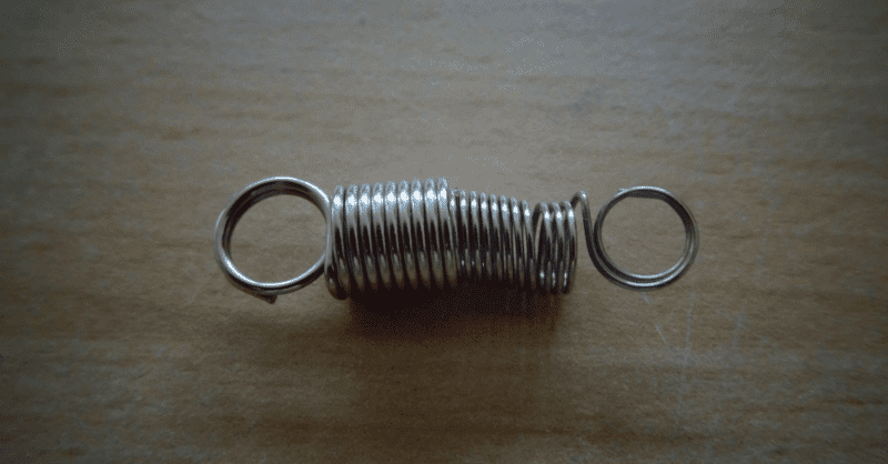

Yes, it is said that all oscillators are probably containing some nonlinearity. But the thing is that they aren't measurable until one reaches a certain amplitude. In order to reduce that amplitude I thought I can create a cone shaped spring analogy by putting several linear springs in series. Like this:
Photo of a metal extension spring with a closed-coil body and a small wire loop hook at each end, lying on a wooden surface.
