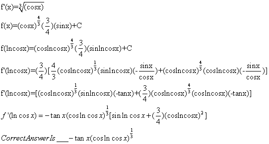

Given that f'(x)=(cosx)^ (1/3) then find out dy/dx f(ln cosx)=?
The answer given is -(cos(lncos)) ^ (1/3) tanx
Anyone can solve it? I tried and got lost with it

By the chain rule, the derivative of f(ln(cos(x))) is f'(ln(cox(x))) times the derivative of ln(cos(x)). And that is the 1/cos(x) times the derivative of cos(x) which is -sin(x).
The derivative of f(ln(cos(x))) is f'(ln(cos(x))) times -sin(x)/cos(x).
Since [itex]f'(x)= (cos(x))^{1/3}[/itex], [/itex]f'(ln(cos(x))= (cos(ln(cos(x)))))^{1/3}[/itex].
Putting those together gives exactly what your book says.
here are my further works
I found out my problem it can't be done
The problem is i can't increase the power of cos x to (cos x)^2 so there is only one shortest way to solve it

Here is the shortest way
f'(x )=cos(x )^(1/3)
f'(ln(cos(x )))=cos(ln(cos(x )))^1/3* d(ln(cos(x )))/dy* d(cos(x ))/dy
=cos(ln(cos(x )))^1/3 * 1/cos( x) * (-sin(x ))
=cos(ln(cos(x )))^1/3 * -sin(x )/cos(x )
=cos(ln(cos(x )))^1/3 * -tan(x )

You're misreading the problem. He's given df/dx=(cos x)1/3, not f(x).
Oh right. I didn't see the dash!
Problem solved :)
