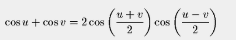

Trigonometric identity written in LaTeX: cos u + cos v = 2 cos((u + v)/2) cos((u - v)/2).

for part a, the lowest two modes are just simply 50hz and 100hz?
if yes, the equation of the complex noise is it just x=2Acos(50πt)cos(150πt)
Since ω=2πf and x=2Acos((ω1+ω2)/2)cos((ω1-ω2)/2)

I do wonder if you have a good idea of what happens.
I thought white noise has a flat frequency spectrum and complex noise has a Gaussian frequency spectrum -- anyway, you aren't after the equation of the noise but after the displacement as a function of (missing in problem statement. x ?) for three moments in time.
The tiles reflect the sound waves and for 50 and 100 Hz there is constructive interference of the waves going back and forth and a standing wave pattern emerges. You get displacements ##\xi(x,t) = \xi_0 \; \cos(\omega t)\; sin(kx)## for ##\omega = 2\pi \;50## rad/s and similarly for ##\omega = 2\pi \;100## rad/s (with its own ## \xi_0## !) and the exercise wants you to fill in the three times for each of the modes separately and sketch. Can you post your sketches ?
