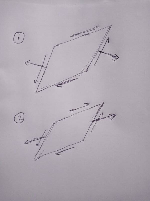

I'm wondering the direction the normal stress should be shown on a deformed material element.
Let's say you have a material element with normal and shear stress. These stresses were computed using stress transformation. When the material deforms, should the normal stress vectors remain normal to the surface (sketch 1) or parallel to the other surface (sketch 2)? Which would be more accurate? Thanks!
A normal stress, by definition, is the component of the stress vector that is normal to the surface. A shear stress is, by definition, a component of the stress vector that is tangent to the surface.
I think you may be confusing the components of the 2nd order stress tensor with the components of the stress vector (first order tensor) on a surface of arbitrary orientation.

That would only be for the components in a change of coordinate system. The stress tensor, the normal to a surface, and the corresponding traction vector are invariant entities, independent of any specific coordinate system and of the components resolved on that coordinate system. Thinking of them in terms of a matrix with rows and columns automatically implies a specific coordinate system.
Do yourself a favor and learn about dyadic tensor notation, which treat tensors as such invariant entities. For a good development of this, see Appendix B of Transport Phenomena by Bird et al. Or see the brief tutorial I presented in post #12 of the following thread: https://www.physicsforums.com/threads/so-tension-is-not-a-force.960204/#post-6089855

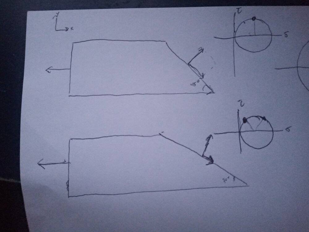

I thought about my question a bit more. I want to use a bit more of a specific, concrete example. Let's say there's a rod under pure tension in the x direction and you apply a 45 degree cut. There would be a normal and shear stress both half of the normal stress in the x direction. If the material deforms under tension however, the angle changes (let's say to a 30 degree angle). In order to maintain force balance, this would be equivalent to a 30 degree cut:
This seems to mean that if you take a section of a material under some stress, the stresses on that section would change if the elasticity modulus changes.
If the strains and displacements are small, the changes in orientation of the plane and of the edges of the material elements are considered negligible. If the strains are large, we are dealing with non-linear material behavior, and you need to learn about the mathematics of large deformation behavior (google Cauchy-Green deformation tensor). If the displacements are large but the strains are small, this can be dealt with mathematically with the kinematics of the deformation, but with linear material behavior.
