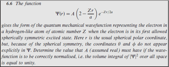

[/B]

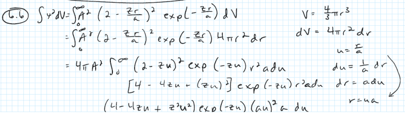

Determine the value that A (assumed real) must have if the wavefunction is to be correctly normalised, i.e. the volume integral of |Ψ|2 over all space is equal to unity.
Integration by parts
(I think?)

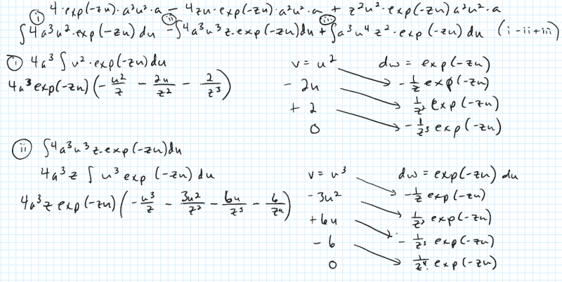

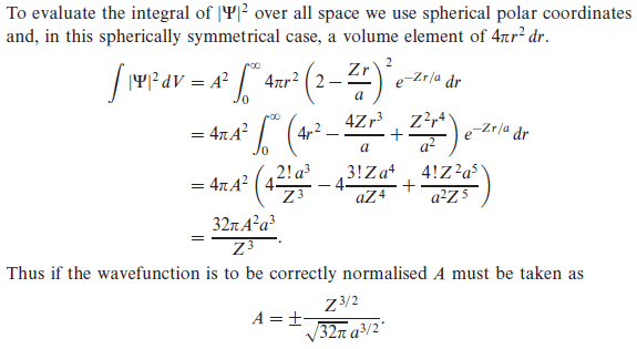

So, I've managed to do the integration correctly (I think), but I don't know where to go from here. I have the solution manual, but it skips most steps, so I don't know how to get there. It seems like it has something to do with writing out e^-x as a sum, since factorials play into it, but I don't know how.
My work:
Solution manual:

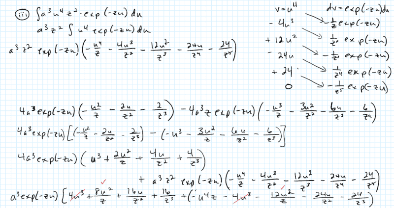

While I didn't check every step - it looks like you got it generally correct. But you haven't evaluated the definite integral yet. In the end, you should just get a number not a function of ##r##. And the mysterious factorials in the book solution are coming from the formula ##
\int_0^\infty u^n e^{-u} du = n!##. It might be handy to remember that, so you don't have to do integration by parts over and over again.

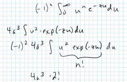

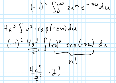

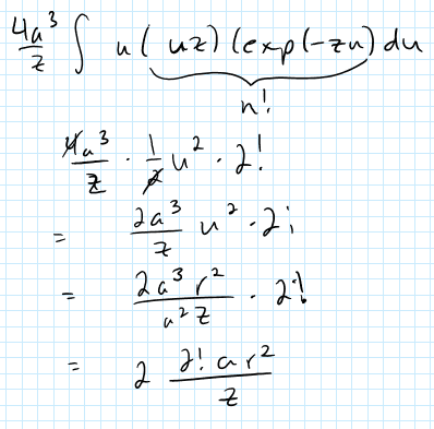

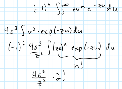

Thanks so much! I had no idea that was a property. So, I tried to work my first term using that property, but I'm not sure I did it right.

Ray Vickson said:
Have not checked your details, but note that you are doing a lot more work than you need to. You want to compute an integral of the form
$$\int_0^{\infty} (a_2 r^2 + a_3 r^3 + a_4 r^4) e^{-cr} \, dr$$
with known constants ##a_2, a_3, a_4## and ##c > 0##.
It is easy to compute ##F(c) = \int_0^{\infty} e^{-cr} \, dr .## Then, since ##(\partial / \partial c)^n e^{-cr} = (-1)^n r^n e^{-rc}## we have
$$ \int_0^{\infty} r^n e^{-rc} \, dr = (-1)^n \int_0^{\infty} \left(\frac{\partial}{\partial c} \right)^n e^{-cr} \, dr = (-1)^n \left(\frac{d}{dc} \right)^n F(c).$$
This avoids integration by parts and most other complications.

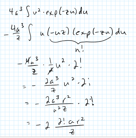

This is also great. I attempted to work it out using that, and I am closer to a solution, but still not sure I computed it correctly.
Not right. You aren't substituting consistently. Change the variable to ##v=uz## and write it completely in terms of ##v##. Then think about it.
BTW you can get the correct answer out of your first effort. But you didn't actually evaluate the definite integral. You need to substitute ##r=0## and then think about the limit as ##r \rightarrow \infty##.

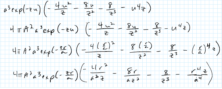

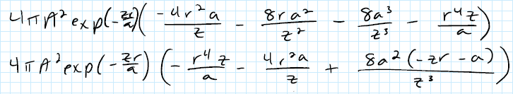

I figured that, but was having a ton of trouble envisioning it. Well, then I went back after you said this, and gave them all the common denominator of z^3. The only term that does not have an r in the numerator becomes -8a^3/z^3, which gives me the correct answer, but negative, but that doesn't matter since the final answer is +- a square root anyway. How does having r in the numerator make all the other terms disappear? Doesn't that mean all the terms go to infinity?
But wait, it's infinity minus -8a^3/z^3, but wouldn't that equal infinity?
Take the example of ##\int_0^\infty u^2e^{-u}du##. The indefinite integral is ##(-u^2-2u-2)e^{-u}##. You have to evaluate it between the limits of ##0## and ##\infty##. The ##0## part is easy, it just gives you ##-2##. For the upper limit you can't just put ##u=\infty##, you need to figure out the limit of ##(-u^2-2u-2)e^{-u}## as ##u## approaches ##\infty##. I claim that ##\lim_{u \to \infty}u^n e^{-u}=0## for any ##n##. You can prove it with l'Hopital's rule, or if this is a physics course you may not have to prove it. So the difference is ##0-(-2)=2## and that's the value of the definite integral.
