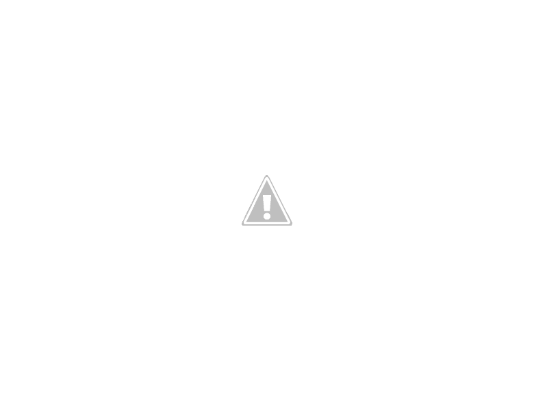

Hi,
So I have managed to get part of the way through solving a circuit that is being made into a Norton's equivalent circuit. But now I'm stuck on the Isc part. I know I have to use the current divider rule, but I'm not sure how to use it in this situation.
Here's a diagram:
JDKxBd6b9ppLRCqsJxT8ytJtKpeolXyRNvsjW_Z749xOBjZcTQS5F6bqQn8W1-6yHLckiMwGWoTK6pY-iws=w780-h585-no.png
What is your equation for current through R2 in the circuit you have drawn?
⏩ Hint: it is always a good idea to redraw schematics while you mull over what approach to take; perhaps redraw multiple ways. Redrawing a circuit in a simpler/neater/alternative way engages the brain in considering different ways of viewing the connections, and often brings sudden insight.
