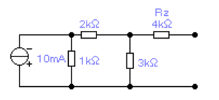

Determine the Thevenin equivalent of the following circuit:
https://imgur.com/a/74UjA (Top image)
The last 3 images in the Imgur album are all different approaches.
I can't figure out what the right one is, and why the other ones are wrong. I spent hours searching on google, and I feel like I understand Thevenin/Norton well -now I am not so sure..-, but to no avail.
Extra information:
- Ub = Usource
- "zal door Rv gaan" means "will pas through Rv"
EDIT: I think my second attempt is correct. Uth = 5V. The 1st and 3rd method are presumambly wrong. I sort of have an idea of why, but I am still not 100% convinced.

Can you write down the steps you are taking eg...
1) Remove load resistors (none to remove in this case)
2) Replace current sources with..
etc
Yes and Rth = 5500 Ohms.
Re: First image/attempt: You appear to be shorting the output to calculate I5 when you should be calculating the open circuit voltage (so I5 = 0).
