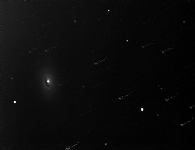

I got a couple of pics, the best of which was one of the Black Eye Galaxy. I have no Idea how good it is supposed to be, I just know its not quite the HST quality lol.
Also, I swear my scope isn't tracking the sky correctly or something...even after enabling the astronomical items setting and such. After like 20 min the item I was looking at was drifting off of my imagers view area. I don't know if my scope just wasn't tracking, or if it was just minor errors that is within it's normal operating range...
Here's my only semi-decent pic. (Semi-decent being as it's my first pic of anything in deep space, and first pic that actually looks like something)
Looks to me like tracking wasn't very good or something. And I have no idea why some dots are spread out everywhere and other aren't.
The streaks don't match the pattern of the stars and the stars are perfectly round. It looks to me like you may have been stacking images and got a handful of images included in the stack that don't belong.
That was auto stacked by the meade software that took the pictures. Hrmm...hopefully the skys clear up soon and I can get back to practicing.
Did you save the originals? You can go back and look at them individually, find the good ones, and stack them with 3rd party software such as Registax. That's how I do it. Envisage is only really good for taking pictures, not for processing. I only look at the auto-stack for informational purposes while imaging (seeing how my tracking is, for example).
Also, I don't know what format you had Envisage saving them in, but you'll need to be using FITS if you aren't already.
Hrmm...no I didn't save them individually, I just left most everything on the default settings I believe. It also saved as JPEG. I'll change the settings and such and try again as soon as I can. Thx russ!
