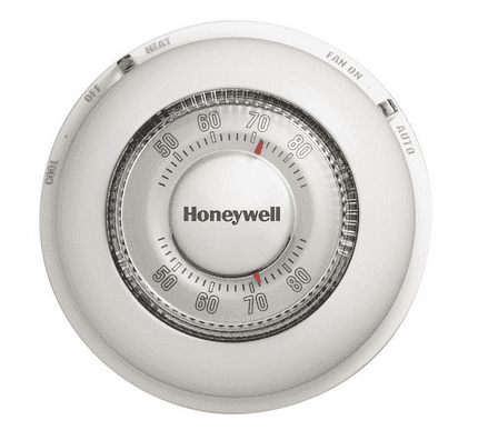

If it's a room thermostat i'd just replace it with an old fashioned spring and mercury vial type..
no computer, no battery, no problem !

I totally agree, however by not knowing the application for sure, you get cool post like this. :devil:
:angel:
