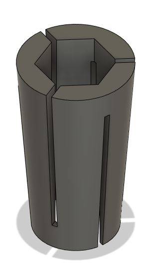

If i have a collet that has a tapered outside to get pushed into a smaller size and a hex hole inside of it and i want the hex to uniformly shrink along the whole collet (so the walls of the hex stays parallell from one end to the other) do i need to add 12 slots or can i do it with just 6 slots like shown in the drawings?
If it can be done with only 6 slots that is preferable because i don't end up with slots in the flats of the hex.
For a correctly sized hexagonal collet, 6 slots should be sufficient, indeed preferable, since the corners of the hexagon are critical to the alignment.
The best hexagonal collet might have slots in the flat faces, so that the alignment of all six corners was maintained.
If the size of the hexagon was different to the collet, then more slots will be required to allow for a greater change in the dimension. That is why a set of round collets have more slots, to allow for intermediate diameters with a mismatched surface radius.

I want to lap/grind the collet after hardening to get a good surface finish and get rid of any distortion from heat treatment, and that plus clamping on a hex that might vary slightly in size and it will slide trough the collet kind of like in a swiss lathe is why i want the flats to remain parallell trough the clamping range. So i get max surface area of the collet contacting the hex it is clamping on. It will be a very minimal clamping range required of maybe 0.1 to 0.2 mm max for a 8 mm hex.
Two flat faces in contact, do not prevent rotation of one face on the other. When turning a hexagonal nut or prism with a spanner, or gripping it with a collet, there is no useful pressure applied to the centre of the face, as it will slip. The corners are more important in that they align in two planes with the hexagon, so they control direction. That is why I would slit six faces at one end, rather than six corners. If you slit three corners, you will have only three pairs of fixed faces, not six.
You mean 3 at each end right? Only slitting one end will make the hex pinch only that end, not the whole length of the collet.
You must slit both ends, but the shape of the collet will decide the closure at both ends.
If you slit 3 faces at one end, you can slit the other 3 faces at the other.
If you slit 6 faces at one end, you can slit the 6 corners at the other.

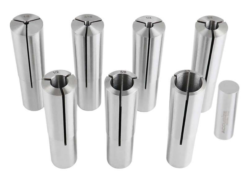

This is what I find on my ER25 collets but aren't they essentially for circular tool shafts? I just wonder whether a three jaw collet would be stronger as there is a 120 degree slot for each vertex of the hex. It may be that the range of tool sizes may be less for the three jaw arrangement but is it a trade-off? Thinking in terms of spanners / wrenches a hex spanner works better (stronger and less deformation as half of the vertices on a normal spanner are not used) - it's just not convenient to get the working angle right.
The problem is that you have to close the slots in order for the collet to not be 3 separate pieces. So if you close the 3 slots in one end, and keep them open in the other the collet will just be able to clamp on the end with the open slots, and with a simple taper along the whole OD of the body it will not be able to clamp at all because the end with the closed slots will resist compressing and stop the collet from going further down the taper.

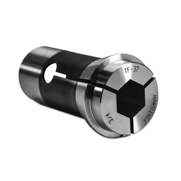

On a 5C collet you can get away with only open slots on one end because the taper is only on the open slot end of the collet, while the rest of the collet OD is straight walled. But this will mean that the collet will only clamp at the very end of the collet, not the whole way down the collet like a ER collet does. That is also why ER collets have a much bigger clamping range than 5C style collets.
On some CNC machine collets for automatic clamping they do a kind of hybrid between the ER style and the 5C style where they only open the slots at one end, and can clamp it by pulling from the rear like a 5C collet, but they move the taper a little furter back compared to the 5C, and have a long flexure section that allow the collet to flex into a parallel clamping situation like the ER collet can. With this design you can get away with 3 slots for a hex, but it is a much more complex design and it has a limited length clamping area because the end will be unsupported because it has no taper.
A collet can be closed by pulling it, with a draw-bar, into a machine taper. But then there cannot be slots cut in the threaded draw bar end of the collet.
A collet that is slotted at both ends, must be en-closed by a cover nut in a tapered chuck, like the ER series collet chucks. The collet chuck can then be held in place with a draw-bar.
You are ignoring the radial flexibility of the thinner-walled slotted shank, between the back of the collet grip and the draw bar thread.

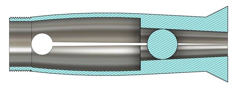

That is what i was writing about the third style of collet. But this flexing to become parallell does require the part that is being held is supporting the ID the whole length of the gripping section of the collet. While a ER style collet will remain mostly parallell even if it is only supported by the part being clamped for a little part of the clamping length because the whole OD of the collet is supported by the tapers and it flexes equally at both ends because of open slots at both ends.
I have illustrated the problem here with a 5C style collet that is clamping a ball further in from the tapered end:
As you can see the ID of the clamping section does not stay parallell because it is not supported by the part it is clamping. This will result in the ball in this example not being able to slide trough the collet if it is pushed (like in a swiss lathe) because the end of the collet is smaller than the ball it is clamping because the clamping part of the collet is being flexed out of parallell.
Intermediate slots at the back end enable better fit all the way along the tool but the range of adjustability will always be limited and, as @Baluncore says, this always will require a holder which compresses the front of the collet as well as just pulling the back end into a rear taper.

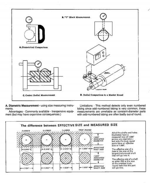

You need is not look at Surface Finish. You need to control of Form Error
We need to control Form Error caused by the production process. This is critical with respect to hydraulic seals, bearing load surfaces, mating surfaces of high accuracy, precision metal parts. Every ID and OD made by a machine tool will deviate from perfect roundness to some degree. You can expect lobing errors from 2 to 9 or more around the circumference of a production part. The spacing and number of lobes can be odd or even, regular or irregular and the height will vary as well.
Causes of Form Error - All surfaces of a typical OD are generated with reference to fixed points, axes or lines of contact in the machine tool, be it centerless grinding, lathe centers, steady rests, regulating wheels, tool edges, grinding wheel surfaces. These points of contact are constantly changing. Tool holders flex, there is imperfect rotation, erratic cutting dynamics, tooling wear, lubrication, rotational imbalance and wear, improper machine tool geometry, all contribute to error. Tool holders and holding fixtures slip, belts wear, drive rollers misalign, chucks distort, localized heating, excessive feed rates, and warped out of round stock all add to the mix.
Finally, it seems that the most common machine tool used, “centerless” Machine tools were designed to make out of round parts! They contact the production part at three points and almost always generate a 3,5 or 7 lobe part.
It should be noted that one could not effectively measure SIZE of high precision parts without knowing the Shape …i.e. effects of form deviation due to lobing error generated during the machining process. Knowing Form Error is mandatory, when assembling tight tolerance precision parts. The time-honored mistake of “ tightening up the Tolerance” will not cure the problem. Control of Form Error will reduce scrap, reduce rework, eliminate waste and save time and money.
Short answer - the more slots in a collet will mean less deformation during the machining process and learn how to measure form error correctly. Micrometers and V blocks won't do it. Long answer is understand form error and this requires your additional work.
