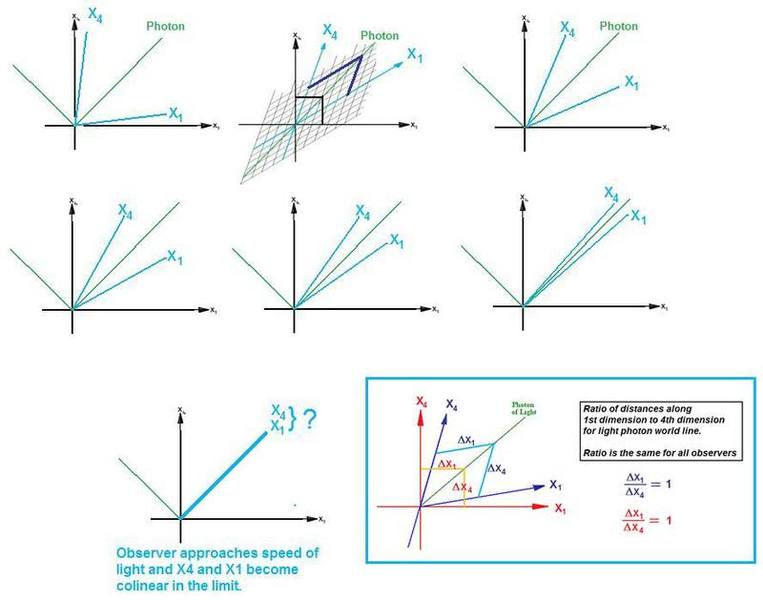

Your question has been answered quite well here. Also, you might consider the problem in the context of space-time diagrams (google it or find discussions of space-time diagrams in other posts). The sketches below show a sequence in which an observer (blue frames of reference) moves at ever greater relativistic velocities with respect to a rest frame (black perpendicular coordinates). One aspect of the photon (any massless boson) that makes it so special is that its worldline always bisects the angle between the time axis and the spatial axis for any observer, no matter what the observer's speed (thus, the speed of light is the same for all observers).
Notice in the sequence that the moving observer's X4 and X1 axes rotate toward each other, getting closer and closer to each other as the speed of light is approached. In the limit the X4 axis and the X1 axis overlay each other. So, if the observer were actually moving at the speed of light, both his time axis and his spatial axis would be colinear with the photon worldline. How would you define that as a coordinate system?
Notice in the sequence that the moving observer's X4 and X1 axes rotate toward each other, getting closer and closer to each other as the speed of light is approached. In the limit the X4 axis and the X1 axes overlay each other. So, if the observer were actually moving at the speed of light, both his time axis and his spatial axis would be colinear with the photon worldline. How would you define that as a coordinate system?

I didn't get well this graphical explanation, would you please elaborate.
