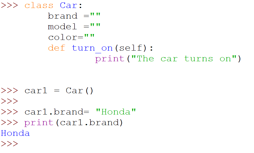

fog37 said:
Thank you. I will rerun it today and show the results
So @fog37 , what happened when you ran your Code2?
Hi phyzguy. This is what I tried:
Code:
class Car:
    brand = ""     # 1st empty attribute
    model = ""    # 1st empty attribute
    color = ""      # 1st empty attribute
    def turn_on(self)
    print("the car turns on")
I wrote the same class this time using the __init__ method:

I don't fully appreciate the difference between the two codes. The 2nd code with __init__ seems to force all objects created from the class to have specific attributes from the get go. But in the first code we do create the same three attributes though... I also noticed that I am not specifying if the attributes are integers, string, etc. I guess the data type does not play a role?
Here the first code being executed:
I read that when an attribute (same thing as field?) is declared outside of the constructor __init__, it is called a "class attribute" instead of an "instance attribute".

But how about the two codes I just posted? What difference would it make to do one or the other?
fog37 said:
Thanks. I will go back and run that specific code.
The point of the constructor is to be able to assign instance attributes when the instance is created.
Python:
myCar = Car("Aston Martin", "DB5", "silver")
Ok. I see. Without the constructor (my Code #1), we still have created empty class attributes which we can modify in content later. So the constructor is convenience...
phyzguy said:
To be honest, I didn't know you could define the class attributes ouside of the init function like you did in you first code. I always use the init function.
The attributes defined directly in the class block, outside any method definition, belong to the class, not the instance. Attributes assigned to self inside a metbod belong to the instance, since that's what self refers to.
Likes fog37 and phyzguy
Per my previous post, the first one assigns attributes to the class. The second assigns attributes to the particular instance of the class that is being initialized.
To see the difference, consider the following transcript of an interactive Python interpreter session:
Python:
>>> class Test:
...     brand = ""
>>> Test.brand
>>> t = Test()
>>> t.brand
>>> t1 = Test()
>>> t1.brand = "Honda"
>>> t1.brand
'Honda'
>>> Test.brand
>>> t.brand
>>> Test.brand = "Default"
>>> Test.brand
'Default'
>>> t.brand
'Default'
>>> t1.brand
'Honda'
Notice that, first, setting the attribute on an instance overrides the attribute set on the class, but the attribute set on the class is still there, and still appears as an attribute of any instances where it hasn't been overridden. This is a common way to set default values for an attribute, which some class instances might override, but others won't.
