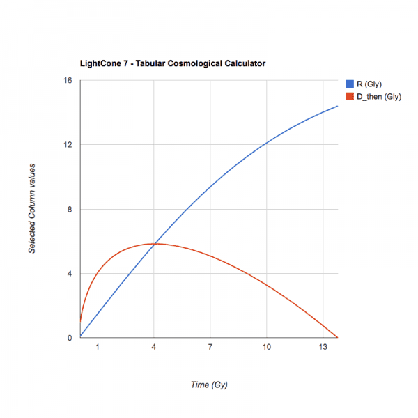

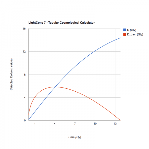

Hi Virgil, glad you found that interesting, and I hope you will contribute some more to the discussion. Here is a simple graph of how that story. The red curve shows the past experience, collectively, of photons we are now receiving. The ones that were emitted recently had an easy straightforward job getting here. The ones emitted a long time ago, like in year 1 billion, at first got farther away because the space they were traveling thru got farther away (canceling their forward progress).
The blue curve is the Hubble distance which grows and in a sense reaches out to photons so that some of them eventually make it even though they may have, at first, gotten farther away (because the distance to the space they were traveling thru was increasing.)
You can see that some of the photons we are receiving today started out in year 1 billion at a distance of 4 billion LY (if you could have paused geometric expansion at that moment to have time to measure, with radar or string or however)
As long as they were outside the Hubble radius they made no progress, got farther way, their motion thru space canceled by the distance growth.
As long as the red curve is above the blue, things get worse for them.
But the blue curve is always rising, the Hubble radius is extending, and at a certain moment, in year 4 billion, the photon finds itself making ZERO progress but at least not being dragged back. It's forward motion thru space is exactly canceled by the space getting farther away.
The curves cross there, and after that, after year 4 billion, the photon makes progress and gradually reduces the distance to us.
It is always traveling thru space at the standard speed c. but now because it is within the Hubble radius the space it has to travel is not not growing so much.
You can see that the turnaround distance is about 6 billion LY, half way between the 4 and the 8. More precisely it is 5.8 billion LY.
So some of the photons that are coming to the HST (hubble space telescope) at this moment started out towards us in year 1 billion at a distance of 4 billion LY and got "dragged back" for the first 3 billion years so that they were actually 5.8 Gly away, and then were rescued by the slowing rate of distance growth (the Hubble distance is ONE OVER THE RATE, the reciprocal of the rate, so as the growth rate declines the Hubble distance increases, as the blue curve shows.)

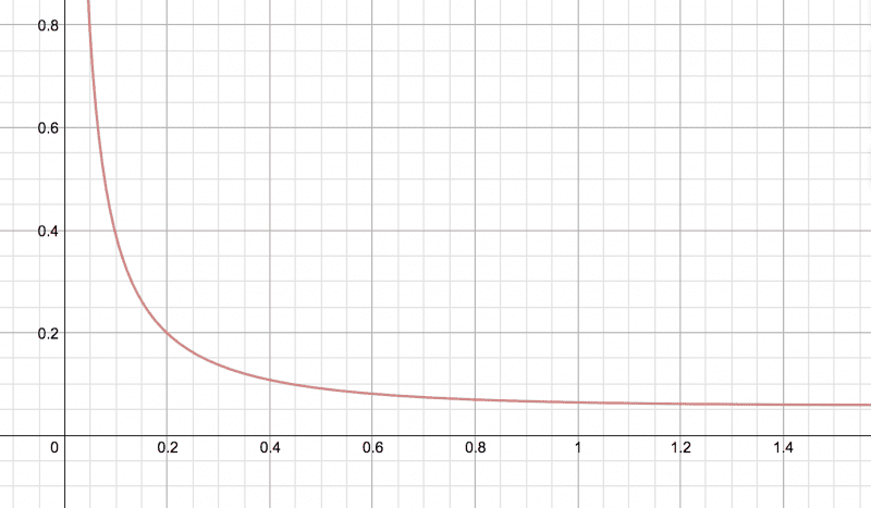

Chalnoth said:
My point is that the distances between individual objects increase at an accelerating pace, but the rate of expansion is still dropping and approaching a constant value.
Good point! Here is a plot of the distance growth rate (the socalled Hubble parameter) over time.
The present is at 0.8 on the x axis.
I don't happen to have a plot of it with the x-axis labeled in billions of years and the present labeled "13.8"
The time scale here is 17.3 billion years = 1.
So 13.8 billion years = 0.8.
But aside from the time scale it gives a good idea of how the expansion rate has changed over time:
The growth rate is expressed as the fractional amount of growth per billion years if expansion would stay constant at that level for the whole billion year time interval.
Readers can see that at x = 0.1 the rate is 0.4 per billion years
The rate is such that if it stayed steady all that time then in a billion years the distance would be 0.4 or 40% longer.
Of course the rate does not stay steady, it declines. So maybe we should imagine a briefer time interval.
That same rate would be 0.0004 per million years. Or 0.04 percent per million years, if it's easier to think about it that way rather than as 0.0004.
Is it clear that at the present time (x = 0.8) the growth rate is about 0.07 per billion years? If you go out to x = 0.8 then the curve is a little more than one square up. One graph square is 0.05, two squares is 0.1. The curve is about 7/10 of two squares up, so it is at 0.07.
0.07 is about 1/14. So at the present rate, if it would remain steady that long, in a billion years a distance would increase by 1/14 of its size.
That is the same as saying the Hubble time is about 14 billion years, or expressing the same thing as a distance, the Hubble distance is 14 billion LY.
That is what is meant by saying the Hubble distance is the RECIPROCAL of the rate. It is a convenient handle on the growth rate which is easier to grasp than these very tiny numbers and which lengthens inversely as the rate declines.
As Chalnoth just said, the rate is dropping and approaching a constant value. You can see that in the plot.
The curve is leveling out around 0.06 or 1/17 per billion years.
By the same token, the Hubble time is INCREASING AND LEVELING OUT AT 17 BILLION YEARS or more precisely at 17.3 billion years. And another way of saying that is the Hubble distance is increasing towards a longterm level of 17.3 billion LY. Hubble time and distance are both convenient inverse handles on the growth rate.
That is what the longterm growth rate level of 0.06 shown by the curve means.

Hi,
I reproduced the graph.
- for the part where the photons were outside of the Hubble radius, does that mean they weren't visible?
- I added D_now to the graph. What is the difference between D_then and D_now?
Thanks

Let me try to explain, just the red curve, Dthen. This tells us the histories of all the photons which we are receiving at our telescope today.
Today is year 13.8 billion. Some of the arriving photons were emitted fairly recently, comparatively near by. Like emitted in year 10 billion at a distance of around 3.3 (does the curve at 10 look to you about 3.3 high?) It approached us on an almost straight line timetable. Sliding down the red curve, so to speak. Getting nearer at an almost constant speed.
All the photons traveled along this curve, so to speak, to get to us.
One was emitted at year 4 billion, at a distance of nearly 6 (do you read it at 4 as a little less than 6 high?)
At first he made hardly any progress. The curve of his distance from us is nearly level. He doesn't get much nearer.
But after 6 billion years have passed it is year 10 billion and he has gotten within 3.3 of us. His distance from us follows the curve down. The curve shows his progress.
In year 10 this old photon could just be passing where the other photon I mentioned is emitted (in year 10 billion). They are both 3.3 from us, traveling together at the same speed, down the red curve, arriving here at the same day.
And then there is the photon who was emitted in year 1 billion, at distance 4.
He arrives on the same day as the other two.
He is aimed towards us but at first he is keeps getting farther because he is traveling thru space which is getting farther.
Eventually in year 4 billion he is almost at distance 6 from us, and he meets the photon which was emitted just then at that same distance, and the two travel together.
At first they make hardly any progress, as I said before, because they are traveling at speed c thru space with is getting farther from us at speed c, but finally by year 10 billion they are only distance 3.3 from us and they meet up with the third photon which was just emitted in year 10 billion. The three travel together and arrive the same day, today.
For the sake of narrative I assumed they were all coming from the same direction, just emitted at different times. they could have been coming from different directions and just arrive simultaneously. The curve only describes the time&distance relation of all the photons arriving today from all directions.
Dthen tells the distance to the galaxy that emitted the photon when it emitted it so it tells the distance the photon was from us when it started.
Dnow tells what the distance to the galaxy is now today when the photon finally gets here.
If distances and wavelengths have expanded by a factor of 2 while the photon was en route then the distance to the galaxy now will be twice what it was then.
By convention we call a factor of 2 expansion by the name "redshift z = 1"
The redshift number is, by astronomers' tradition, always one less than the actual expansion factor.
If you use Lightcone to make a table and include the expansion or "stretch" factor S they you may notice that the Dnow is exactly S times the Dthen. In the row where S=2, the distance now is twice the distance back then when the light was emitted.
