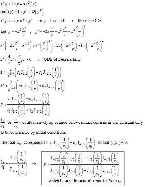

Hello !
I don't think that the ODE can be analytically solved in using only standard functions.
So, I strongly suggest to use numerical methods instead of searching an explicit solution.
Nevertheless, approximate analytic solutions can be obtained, depending on the range where they are derived. An example is given in attachment.
