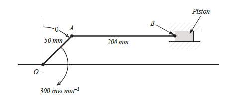

For the mechanism shown in FIGURE 1 determine for the angle θ = 45°:
(i) the velocity of the piston relative to the fixed point O (VBO)
(ii) the angular velocity of AB about point A (i.e. ωAB)
(iii) the acceleration of point B relative to A (aBA).
Note: Link AB is horizontal when θ = 45°
this is a self study question which I am struggling with, can anyone offer some guidance please?
Angular Velocity, ω = 10∏ rads/sec
VAO = ω x r = 0.05m x 10∏ rads/sec = 1.571 m/s
θ = 45
VAO = 1.571 m/s
Sin(45) = VBO / 1.571
VBO = Sin(45) x 1.571 = 1.11 m/s
Is this correct so far?
WAB = VBO/r = 1.11 / 0.2 = 5.55 rad/s-1
can anyone confirm if the above is correct please?

can you just use w^2 X r or (V^2)/r for the acceleration
Forget about the connecting rod being level at this instant, and instead think of the situation with very small theta, so that the crank pin is above the wrist pin, giving the connecting rod an inclination phi.
Now write these two loop closure equations:
r*sin(theta) + L*cos(phi) - x = 0
r*cos(theta) - L*sin(phi) - e =0
where
r = crank radius
theta = crank angle from vertical as given
L = connecting rod length
phi = angle of connecting rod with the horizontal
x = horizontal distance from crank pivot to wrist pin (on the piston)
e = offset from crank pivot up to piston center line.
For any assigned value of theta, you can solve the second equation for phi.
With those two values (theta, phi), you can evaluate x from the first equation.
Differentiate these equations once to find velocities, and differentiate again to find accelerations. It is really very, very simple, provided you are not afraid to differentiate!
For part (iii) I am unsure how to solve using vector diagrams.. I think the crank being offset has thrown me
I worked out aOA = 49.349m/s^2 and aBA(radial) = 6.161m/s^2
