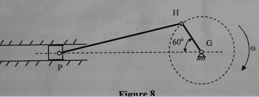

The instantaneous configuration of a slider crank mechanism has a crank GH 10cm long, the connecting rod HP is 50cm. The crank makes an angle of 60 degree with the inner dead centre position and is rotating at 110 rev/min. Determine the velocity of the piston P and the angular velocity of the link HP.
urgent help is needed! i have an exam soon & i have no example of this type of question to work from. please help!

can you provide a diagram? :confused:
here is the photo of the diagram
ah!
ok, call the G angle θ, and the P angle ψ (so dθ/dt = ω),
find the equation relating θ and ψ,
then use the chain rule to find dψ/dt :smile:
