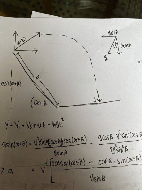

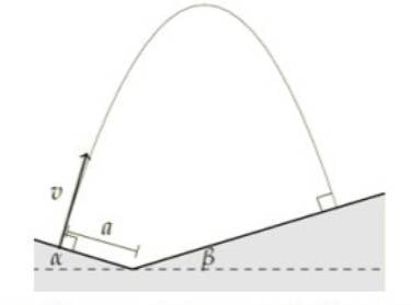

A particle is shot perpendicular to respect to the inclined plane with inclination α, with initial velocity v. Determine the value of v so that the following particle hit the incline plane with inclination β perpendiculrly. The distance between the lowest point to the launching point is a.
I have been struggling all day trying to solve this by using a method which involves tilting the ground so it makes an inclined plane with inclination α+β, here are my steps
Given in my attempt
So using the projectile equation I got ##a\sin (\alpha + \beta) = v\sin (\alpha + \beta)t + \frac{g\sin \beta t^2}{2}##
To find t we use the other projectile equation:
Since the horizontal velocity must be 0 for it to hit the ground perpendicularly we set the equation to be:
##0 = v\sin (\alpha + \beta) - g\sin \beta t## \\
##t = \frac{v\sin (\alpha + \beta)}{g\sin \beta}##
please help solve using this method

What other condition must be satisfied when the projectile hits?
The acceleration along your new y direction is not g, is it?

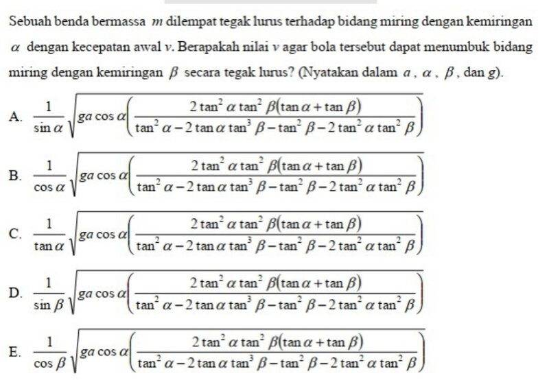

Is this a multiple choice question with the correct answer being one of A - E in the third photo? If so, then I see two courses of action
Plan A: Solve the problem correctly and compare your answer to what is given.
Plan B: Solve the problem for a special choice of ##\alpha## and ##\beta## and see which of the given five answers reduces to what you know to be the case.
I went with plan B and I chose ##\alpha = \beta = 45^o.## Then,
(a) the projection and landing angles relative the horizontal are also 45°;
(b) the trajectory is symmetric about the point where the inclines meet;
(c) the projectile returns to the same height from which it is launched;
(d) the horizontal range of the projectile is ##R=\dfrac{v_0^2}{g}##;
(e) the horizontal range is also ##R=2\times a \cos(45^o)=\sqrt{2}a##.
It follows, then, that when ##\alpha = \beta = 45^o##, ##v_0^2=\sqrt{2}ag.##
Which of the five choices gives this result? I leave that up to you to figure out.

I doubt that any of the answers will match the special case I chose. Look at what happens to the denominator when both tangents are equal to 1. I will try plan A at some point because this is one projectile motion problem I have not seen before. The algebra and the strategy can be simplified with the shortcut equations (4) and (5) in this insight that I put together a few months back.
Google translate tells me that "Sebuah benda bermassa m dilempar tegak lurus terhadap ##\dots~##" is Indonesian for "An object of mass ##m## is thrown perpendicular to ##\dots~##"

Welcome, SayedD!
Could you verify that the "lowest point" is the correct translation?
If so, what would the meaning of that point would be, other than the intersection of both surfaces, each of those being perpendicular to the trajectory?
I believe that tilting the planes and the direction of gravity can't simplify things in this case.

I wonder if a is supposed to be the direct distance between launch point and impact point ?
the variables are shown clearly in the second (middle) image; and it appears to be typeset rather than hand-drawn (so I take it to be correct and not a mis-interpretation). That said, I have still not solved this one. I hope to get some time later today.

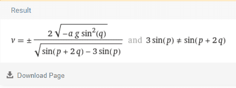

Here is the calculation on WA.
It does not look at all like one of the given selection but it does pass the "Kuruman test" with ##\alpha=\beta=45^{\circ}##. For a projectile launched with velocity v at 45 degrees, maximum horizontal range ##v^2/g## is achieved and that works out to ##\sqrt{2} a## as expected. Note I have used p and q for the angles on WA
Here is the "Kuruman test" calculation in which I have replaced p and q with ##45^{\circ}##.

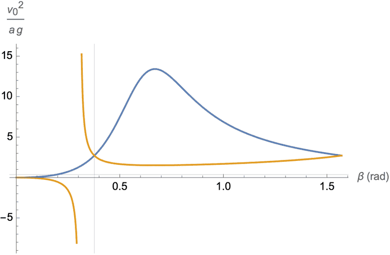

Option A passes the "improved Kuruman test": ##{v_0}^2=\frac{ag}{\sin{\alpha}}## when ##\alpha=\beta##. Except that the sign is wrong. It fails the test with ##\beta=90^{\circ}## claiming 'undefined' presumably because it attempts to evaluate ##\tan{90^{\circ}}##
Here is what I found after some investigation.
My ghastly expression is $$\begin{align}v_{\text{0A}}^2=\frac{2 \sin (\alpha +\beta )}{2 \sin (\alpha ) \sin (\alpha +\beta )-\frac{\cos (\beta ) \left(\sin ^2(\beta )-\sin ^2(\alpha )\right)}{\sin ^2(\beta )}}.\end{align}$$ Your (neater) expression is $$\begin{align} v_{\text{0B}}^2=\frac{4 \sin ^2(\beta )}{3 \sin (\alpha )-\sin (\alpha +2 \beta )}.\end{align}$$ The expression in choice A with the denominator multiplied by -1 to make it positive when ##\alpha=\beta~## is $$\begin{align}v_{\text{0C}}^2=\frac{\cos (\alpha ) \left(2 \tan ^2(\alpha ) \tan ^2(\beta ) (\tan (\alpha )+\tan (\beta ))\right)}{\sin ^2(\alpha ) \left(2 \tan (\alpha ) \tan ^3(\beta )+2 \tan ^2(\alpha ) \tan ^2(\beta )-\tan ^2(\alpha )+\tan ^2(\beta )\right)}.\end{align}$$
I. Equations (1) and (2) give identical results but equation (3) does not. I verified this by fixing ##\alpha## to some value and plotting ##v0^2## as a function of ##\beta## from ##0## to ##\pi/2##. The graphs for (1) and (2) were on top of each other whilst the graph for (3) was not. From now on I will refer to equations (1) and (2) collectively as "our equation" and equation (3) as "their equation" by replacing sines and cosines with tangents.
II. The condition for our equation to be positive is $$\tan(\alpha)>\frac{\sin(\beta)\cos(\beta)}{1+\sin^2(\beta)}.$$The ratio on the right has a maximum value of 0.3535 which translates to ##\alpha > 19.5^o.## In other words, as long as the above condition is met, our equation will always have a solution. This is not true for their equation which changes sign in the region ##0<\beta<\pi/2## no matter what one chooses for ##\alpha##. I verified this last result by doing several plots. The one below is for ##\alpha = 21.6^o##. The blue line is our equation and the orange line is their equation. The vertical line marks the value of ##\alpha##. It is ironic and instructive to see that our equation matches theirs only at ##\alpha=\beta## and ##\beta=\frac{\pi}{2}##, i.e. both equations pass the tests that I proposed in post #12.
III. Both our and their equations agree when ##\alpha = \beta## and when ##\beta = \frac{\pi}{2}.## One can get around the "undefined" problem with their equation (3) if one divides both numerator and denominator by ##\tan^3(\beta)## and then take the limit as ##\tan(\beta)\rightarrow \infty.##
Edits: After some algebra, I was able to transform equation (1) into equation (2) so they are identical. I wonder if it is worth anyone's while to see how close one can get to their equation.
Also edited to add the vertical line at ##\beta =\alpha## in the plot.
Final edit: Equations (1) and (2) can be algebraically transformed to one of the options with the negative signs in front of the factors of ##2## in the denominator flipped to positive signs.
