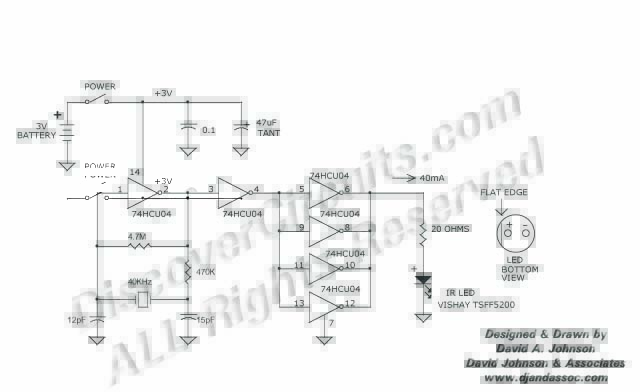

Is it better to use an op-amp oscillator or a crystal oscillator to produce 40 Khz sine wave?
See simple Wein sine-wave oscillator at
http://hobby_elec.piclist.com/e_ckt18.htm
Bob S
I know I built that one and got around 40 Khz. I wasn't too happy with distortion and precision. I was considering building a quadrature oscillator, but wanted to know what people thought about using crystal ones.
In the above circuit, if you take the output only from pin 1 of the crystal oscillator inverter, it should be a fairly good sinewave. Its frequency will be accurately controlled by the crystal.
It is unconventional to to take the output from what is an input, but the waveform here will be better than at the output of the inverter.
If you did get some distortion, you could filter it to get rid of harmonics.
There is no need to wire up the circuitry involving the other 5 inverters if you don't want to.

As I mentioned, pin 1 of that chip will have a sinewave on it.

I read that as '1 pin'. I'm not at all clear how stable the amplitude of any given crystal, or variation in amplitude over a part numbers is from a driven crystal. Do you know anything about that?

I have used this circuit as a local oscillator for receivers (although not at 40 KHz).
The input to a CMOS gate is very high impedance, so you have to take the output to some device that is also high impedance. To maintain the sinewave, this would probably mean a FET either as a source follower or a common source amplifier.
A I recall, the sinewave here could be very clean looking on an oscilloscope, although this may not always be the case, I guess.
The signal level is large (several volts p-p) and absolutely steady as long as the load does not vary. And, you can't match the precision and frequency stability of crystal control.

Loading low frequency crystals isn't much fun. It doesn't take much to swamp the oscillator. Definitely a place to use an FET follower and be careful with the leads.
