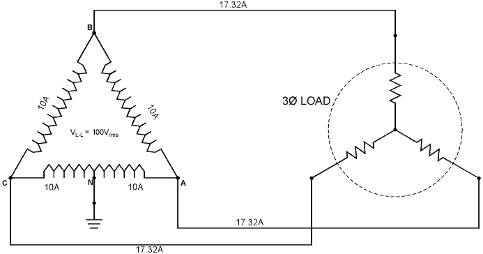

While studying a numerical on open delta system .., we have to find total kVA rating of V-V bank so obviously it should be equal to = root 3 *(kVA rating per transformer in V-V bank)..
But in the solution , its is taken as =root 3 *(kVA rating per transformer in delta-delta )..!
So , isn't it a mistake in the textbook..??

If one has to determine sizes, first let's explain the why the cores are oversized. In the following example we have a typical 3Ø load connected to a [closed] delta secondary operating at 100Vrms (just to make calc's easier).
So here our calculated load is: 17.32A × 100V × √3 = 3kVA.
And as seen by the "transformer": 10A × 100V × 3 = 3kVA
Now let's compare to the same load powered by an open-delta secondary.
Here our calculated load is the same: 17.32A × 100V × √3 = 3kVA.
But as seen by the "transformer": 17.32A ×100V × 2 = 3.464kVA
As such, each winding must be sized for 1.732kVA. That gives us a ratio of 1.732 to 3, which is 57.7% of the load.

hmmmmObserve in that Mike Holt link referenced up there in post #2
where he starts with three 1 KVA transformers serving a 3 KVA load
that with Δ-Δ you can use the total of all 3 transformers, 3KVA
But with open delta, to supply a 3 kva load required two 1.732 KVA transformers...as he showed.
What if instead of upsizing the transformers to supply the full 3 KVA , he just downsized the load to match what the two remaining transformers can deliver?
How many KVA could he get out of two 1 KVA transformers connected open Δ ?
Hmm.
Now his two transformers can only supply ten amps to the lines
so all three line currents would have to be reduced to 10 amps..
KVA three phase still equals Vline X I line X √3, and that = 100 volts X 10 amps X √3 = 1.732 KVA
which looks to me like √3 X transformer rating.
So i can see nothing wrong with the statement you cited.
With three transformers in Δ-Δ you get 3X transformer rating
but with two transformers open Δ you don't get 2X transformer rating you get √3 X transformer rating.
1/√3 is 0.577, which rounds to 58% , the number in that Purdue link.
Looks consistent to me.
