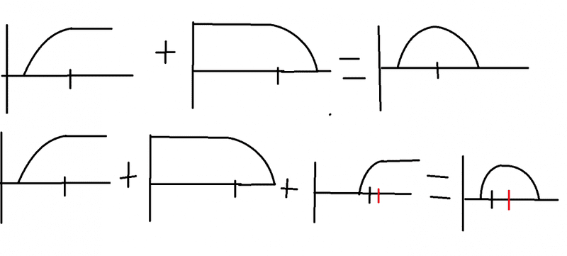

So if I use 2 lowpass and 2 highpass, I'm not understanding conceptually how that will necessarily fix the problem. So I'm basically limited by the second derivative of the graph, right? V out vs. omega. By adding in another lowpass, in attempts to steepen the peak, one would be tempted to set "unity" at a higher frequency to have a steeper dropoff at the left. Won't this then mess with my peak at 10k?

The center frequency stays the same, but the rolloff rate is enough higher to meet your requirements. Unity remains at 10 kHz.

Oh, because all the gains on the LHS of the vertex will be less than 1 and multiplied, and same with the RHS. Correct? So would both my lowpass filters have the same RC values?

Ignore that picture, it is as of now irrelevant. It was an attempt to explain my confusion.

Yes, yes. I think I get it now. What would be a reasonable, physical approximation that I could use to get my values? I.e. how I was trying to maximize it at 10k by setting both circuits in phase with each other and they would maximize due to superposition or something along those lines, or as was mentioned early where z_1 = R_1 at 3k, etc.
