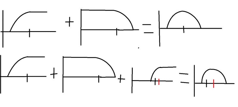

I think a better method for you to use would be to consider your circuit to be two voltage dividers in cascade. Imagine that you designate the node at the top of C1 as Vx.
Now R1 and C1 form a voltage divider with input at Vin and output at Vx. Then C2 and R2 form another voltage divider with input at Vx and output at Vout.
But the situation is complicated. If the first voltage divider consisted only of R1 and C1 it would be trivial to derive the transfer function of that voltage divider; it would be z1/(R1+z1). The problem is that the output part of a voltage divider consisting of only R1 and C1 would be the shunt impedance z1.
Your actual circuit has more than just z1 as the output load of the R1 and C1 voltage divider, so that has to be accounted for. Do you know how to do that?

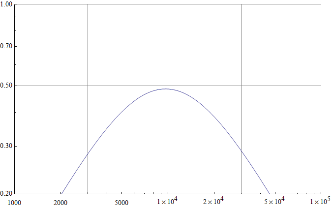

There's no point in trying to optimize. Filters made using only R and C are very limited. They can have no complex poles; the poles are all on the negative real axis. The Q is limited. You have almost no degrees of freedom in your choices of values for R and C.
What you need to do for the circuit you have chosen is to place the corner frequencies at 10 kHz. This will put the frequency of the peak (as I showed in post #25) at exactly 10 kHz. You make the impedance of the R and C of the second part of the circuit (the high pass part) 10 or more times higher than the impedance of R and C of the first part. In other words, make R ten times larger, and C 10 times smaller. This makes the loading effect of the second part almost negligible.
Having done this, the attenuation at 3 kHz and 30 kHz will be what it is; you have no control over it. This is why it is a fool's errand to try to optimize anything. This is the case for the circuit you have chosen; I can't speak for any other circuit without analyzing the other circuit.
You will not be able to achieve your requirement with the circuit you have been analyzing. However, if you cascade two circuits of the type you're using, you will be able to meet your requirements, provided that you scale the impedance in successive stages of the circuit as I described above.
You're getting bogged down in math. Don't worry about phase, whether phases cancel, or whether one thing is in phase with another. Just calculate the magnitude of your transfer function vs. frequency.

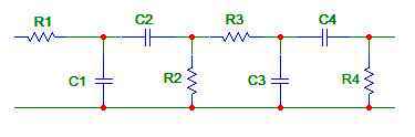

Do you mean use a 4th order circuit?
If so, how would you recommend analyzing it? I'm assuming that there is an easier way than what I'm trying to do.
  • #52
Yes, the cascade of two of your existing circuit will give you a 4th order circuit.
As far as your question about analysis, yes there are easier ways to do it. I'm not sure how you are doing it, but whatever it is appears cumbersome.
Re-read post #23 and #38. Do they make sense to you?

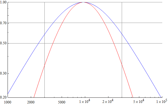

Have a look at this thread: http://forum.allaboutcircuits.com/threads/rc-bandpass-filter-transfer-function-derivation.80000/
I'm home for the evening so I can respond quickly. Let me know if you don't understand all the details.
I gave you some R and C values in post #25, and showed a plot of the magnitude of the transfer function over a frequency range. Can you get those same values?

Have a look at the result the TS got in that other link: http://forum.allaboutcircuits.com/attachments/results-transfer-function-pdf.51260/
  • #59
Any chance you could bring the picture here? I have to create an account to view attachments.
  • #60
Here it is:
