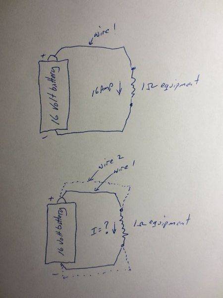

As per the diagram, how do i change the wiring of the equipment on the outside to achieve my desired setup?

there's no point if the power outlets are on the same phase, you won't double the current
This also causes a safety issue in two ways. First if you plug only one branch in you will have live prongs exposed on the other. Second if one breaker is opened for some reason the circuit will be energized through your death cord.

What would the current be in the bottom circuit?
The current would be 16A, but that's cause there is only 1 voltage source. But in the OP's picture there are 2 voltage sources so each can provide 8A current.

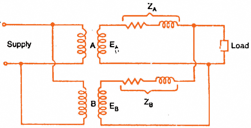

Isn't that how parallel operation of transformer or generator works? Each transformer or generator provides with half the load current?

OP is not clear - but I am reading Power Supplies to mean a piece of equipment, not just an outlet.
1) For an AC source - the Power supplies need a way to synchronize their outputs ( be in phase with one another)-otherwise they may get damaged or as one "competes" with the other - they both shut down under a current fault, or get damaged.
2) To Share the Load 8 A each to supply the 16A Load they need to have a load sharing feature, they need to communicate. Otherwise one Power supply will typically carry all of the load, or if regulated, will put out it's 13A limit, and then go into a current limit - as the other one only has 3A - this could damage the 13 A - or the system could oscillate.
Basically - if the two PS are not made, and configured to load share load current they wont.
Jaus -- in the 2 transformer case, very slight differences in the transformers can lead to circulating current, but paralleling Transformers is possible when properly matched. In the generator case - the generator controls must be equipped to be tied to the grid, or to another generator - primarily to carry out the two functions Synchronization and Load Sharing, I mention above.

There may be a solution using a pair of isolation transformers, but these are heavy and very expensive so expect the cost to exceed $1000. Still interested?
Tell us more about the 16A and the 13A power supplies and the appliance itself. How much power does it actually draw? What is the wattage stated on the rating label?
It sounds like you might be moving country from somewhere that has 16A plugs/sockets to somewhere that has 13A plugs/sockets. In which case there might be an easy solution if the power/wattage is below 3kW.
In some countries you can replace a 13A socket with a 16A socket. There is a bit more to it but that might be a valid solution.
NO, as I said, it's the same source because it's most likely two AC outlets off the same mains phase
davenn said:
two AC outlets
That is the assumption I made as well due to the ends of the cables being terminated in something that looks like a British wall plug and 13A which also matches British style wall plugs. This configuration *MIGHT* work as it parallels two 13A fuses inside the plugs. But it creates an electrical death hazard. Locally if one plug comes unplugged due to exposed prongs and possibly longer distance if two circuits are bridged with this thing.
Do not do this. It is dangerous and probably illegal.
BoB
I can see a way to prevent the danger with two plugs but I'm not going to suggest it because it would only take a single device to fail and the hazard would return. Way too dangerous.
