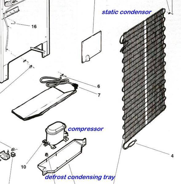

openbahr said:
Half inch because I figured a smaller diameter
pipe would put more water in contact with
pipe walls.
Your intuition is good! The smaller the diameter, the larger the ratio of surface area to volume, and the more efficient use of your space.
But, there's another thing you need to consider. The smaller the diameter, the less light from the sun hits the pipe, so the less heat is transferred.
You could have the best of both worlds by bending this pipe back and forth like the coil in this picture:
That way, you get the most surface area in the least space and you get the largest exposed area to the sun.
In fact that's why they use similar configurations for coils in refrigerators and heating units. Not the "exposure to the sun" part, but the "maximum heat exchange in the least space" part.
