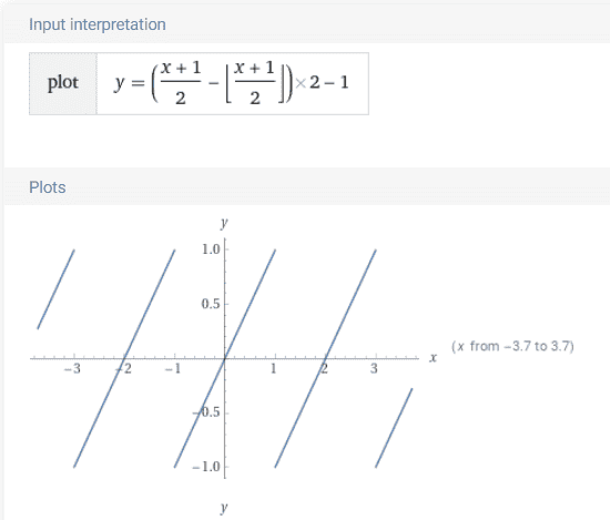

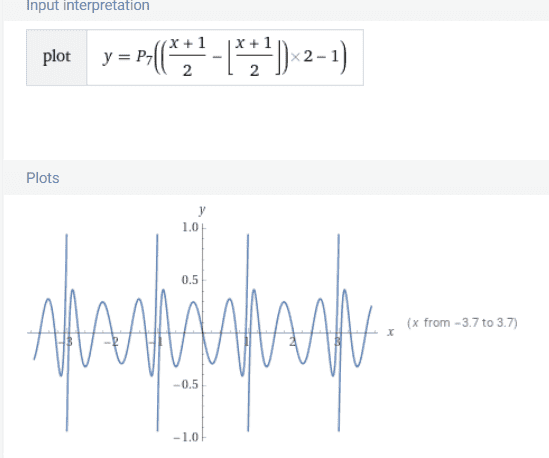

QuantumCuriosity42 said:
To do the equivalent thing with Legendre poynomials, we should choose only one Legendre polynomial, extend it to (-inf, +inf), and having a way of changing its frequency, how could we do that? Is it even possible?
I have already shown
anuttarasammyak said:
To make it periodic is not difficult. For an example new Pn(x) would be
Pn(2(x+12−[x+12])−1)
so that it is periodic outside of [-1,1], where [ ] is floor function.
which is periodic with period L=2 and is defined in ##(-\infty,+\infty)##.
I have no idea of "frequency" you say.

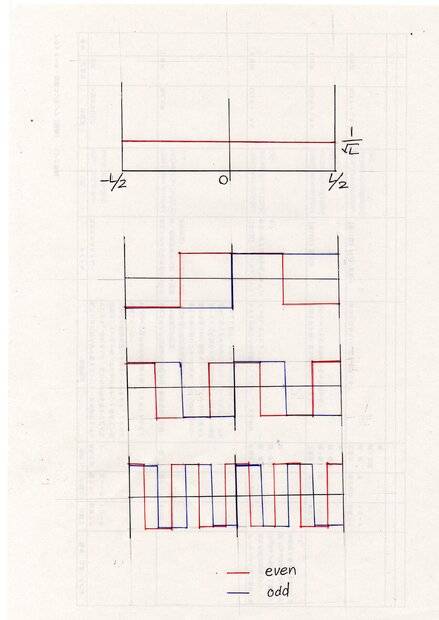

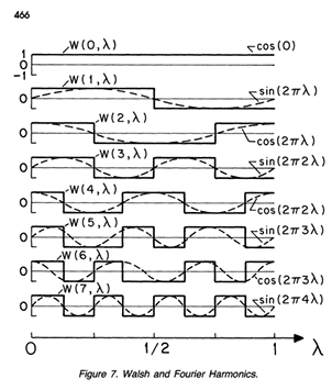

What is n, and what is x there? Can you explain what that expression shows?
I don't see a way to change its frequency.
n is number attached to Legendre polunomials
Graph of the variable of polynomials
So the graph of Legendre Polynomial for n=7 is
You see it periodic in all the region.
