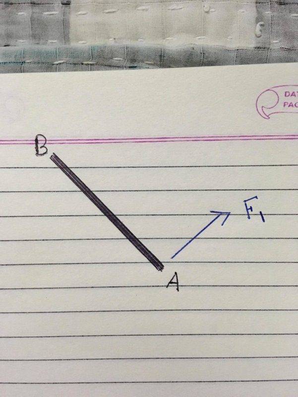

We have a rod ##AB## of mass ##m##, a force (perpendicular to AB) is applied at ##A##.
Free-body sketch of a thin rod with ends labelled A (lower right) and B (upper left), with an arrow at A labelled F1 pointing up and to the right, perpendicular to the rod.
I want to know how much force will ##B## going to feel? When ##F_1## is applied at ##A## rod will rotate about its COM (which lies at the Center) and hence the point ##B## will also move (a little downwards and left). Since, it has moved there must have been some force which would have caused it, what’s that force? (I must mention here that ##F_1## acted only for a very short time, it was momentary, it caused the rotation and went away).

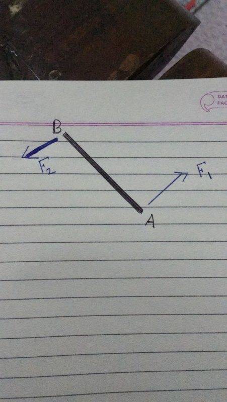

Well, I tried some thoughts. If ##B## were also to act with a force ##F_2## equal in magnitude to ##F_1## like this
Hand-drawn diagram of a rod AB tilted diagonally, with labels A at the lower end and B at the upper left. Force F1 points up and right from A, and force F2 points left and slightly up from B.
Then also, our system will undergo under same rotation (but under a double torque as before) but this time we know for certain that ##B## was acted by a force ##F_2##.
What was the force that caused the ##B## to move in our first case?

Compute the motion of B, then apply F = ma.
How? Guide me a little more.
Torque/Moment ##\tau## ##= \frac{dL}{dt}##, Where ##L## is the angular momentum.
$$ F_1 ~ AB/2 = \frac{dL}{dt} $$
What to do after that?

You are computing angular momentum ##L## about the midpoint of the rod, yes?
What is the moment of inertia of the rod about its midpoint?

##\frac{1}{12} m ~AB^2##. So, angular momentum of the rod is ##L = \frac{1}{12} m~AB ^2 ~\omega##, where ##\omega## is the angular velocity.

Since you know the rate of change of angular momentum over time, this puts you in a position to calculate angular acceleration.

$$ F_1 ~AB/2 = \frac{1}{12}~ AB^2 ~m~ \frac{d\omega}{dt}$$
$$ \frac{6 ~F_1}{AB~m}= \frac{d\omega}{dt}$$

Since you now know the angular acceleration, that puts you in a position to calculate the acceleration of the tip of the rod relative to the center of the rod.
You also have Newton's second law to allow you to calculate the acceleration of the center of mass of the rod.

@jbriggs444 So, we reached up to here $$\text{Angular acceleration}~ \frac{d\omega }{dt} = \frac{6~F_1}{m~AB}$$
What I should do after this?

Since, acceleration of a point is equal to its angular acceleration times the distance of the point from the axis of rotation, i.e. $$ a = \alpha ~ r$$ so, in our case the acceleration of the tip of the rod is $$ a = \alpha ~ AB/2 \\
a = \frac{3~F_1}{m} $$.
Acceleration ##a_{COM} = \frac{F_1}{m}##.

Isn’t the acceleration of rod’s tip ##\frac{3F_1}{m}## ?
No.
That number comes from the rotational acceleration rate. It gives the acceleration of the rod's tip relative to the center of mass.

So, is it $$ \frac{3~F_1}{m} - \frac{F_1}{m}= \frac{2F_1}{m}$$

Yes.
Obviously the direction will be opposite to the force being applied at the other end.

Yes. So, we got the acceleration of the tip of the rod, how we would find the force the ball would experience ?
For a small test ball being pushed continuously by the tip of the rod, Newton's second law applies.

Will the acceleration from the tip of the rod going to be imparted to the ball? If that is so, we would get $$F = M_{ball} ~\frac{2F_1}{m}$$
Right. As I've said at least twice now, my vision is that the ball is nestled against the tip of the rod, being pushed by it. So it accelerates at the same rate.

Thank you so much sir, thank you so much. You have helped me very nicely.
