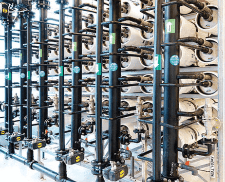

The membrane area is around 35,000.00 m2 when membrane power density is 3.0 W/m2. The membranes are stacked in modules in order to minimize the space. These modules have a high packing density, i.e. large membrane area in a small space.

You are right, the sea water contains microorganisms (size of 0.01 - 10 μm), dissolved solids (size of <0.4 μm), solloidal particles (0.4 - 5 μm) and suspended solids (size of > 5 μm). Consider that an osmotic power plant is similar but the opposite of a desalination plant. The choice of pretreatment method for an osmotic PRO plant is more likely to be made by financial criteria to achieve low capital cost. Statkraft, the company which have costructed the first pilot plant, had used ultrafiltration for this purpose.

This idea sounds like a desalinization plant running in reverse. Instead of using electric power and reverse osmosis to separate salt from water, it produces power while letting the salt mix with fresh water.
I have nothing to say about the viability of the idea, but I want to comment that the problems with structure, filtering and cleanliness should be about the same for desalinization as for osmotic power. There are many desalinization plants already engineered and built.
