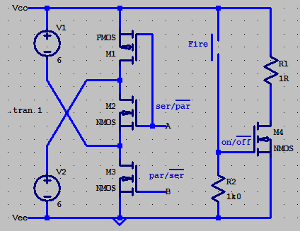

Hi everyone, semi beginner here looking for a little help wiring this system. I am looking to use MOSFETs to handle higher current levels and a DPDT switch with toggle between on+off/series/parallel configuration. My idea for the wiring is here:
However I am not sure how to go about wiring the MOSFETs in with the DPDT, any help with a wiring diagram or education is greatly appreciated, here to both do and learn!

Here is a circuit that you might consider for the job. I offer no guarantee. Any circuit will become explosive if you get it wrong.
Notes:
1. Mosfets have an intrinsic substrate diode, sometimes paralleled by a Schottky diode. The design must account for that ever-present diode in all situations.
2. Controls A and B select parallel or series operation. They should be changed while the batteries are disconnected. Never set A and B high = Vcc at the same time. Always tie B low = Vee when changing A.
3. M1 is a P-Channel mosfet, all other mosfets are N-channel.
4. R1 is the heater element.
5. Press the “fire” button to turn on the heater. Wear safety goggles during testing.

OK, by your schematics I could understand what the OP wants.
Just one remark: switches has an inherent protection against unwanted shorts, what's the distance between the poles.
FETs has nothing like that. There should be some kind of safety delay for switching between the states.
Even better if the 'stable' state is the 'all off', and any switching can be done only through that state.

I considered pull-up and pull-down resistors to safe voltages, but then that current drain would be continuous. It will take a CMOS flip-flop and a couple of gates to build a latch capable of cleanly conditioning the switch, and so managing the A and B gate voltages safely. But designing that is another problem; working out how to minimise the investment in mosfets was enough of a problem.
I think some mechanical solution might be OK. One SPDT to control the FETs...
Maybe this is the case when the 'solution' is just more complicated than the original problem?

Can you control A and B safely with just a switch, without pull-up resistors that waste battery power ?
If the control is a switch, then I think you would need just G-S resistors?
But it's possible that SPDT won't be enough...
Ps.: it would be good to know the expected current. If it's not out of the range what an average switch can handle, then I think the best solution for the problem is to forget it. It can be done with FETs, but it's not trivial. Sometimes the good old switches are just better.

It's harder than I thought. Since there is no fixed voltages in the system and the poles are actually separated by default, it's hard to find an adequate gate drive voltage. Otherwise your schematics fits the bill (with some additional G-S resistors). One more issue. The 4.2V suggests that it's a Li-ion battery. Is the 40-50A fits with the maximal current of the battery? Lead-acid can supply some insane currents for limited time, but Li-ion is a bit sensitive for shorts.
How about going hard series. Then add PWM to the "Fire" control. Instead of high/low/off you get anywhere in between. That is probably easier to make safe and needs only one FET.
