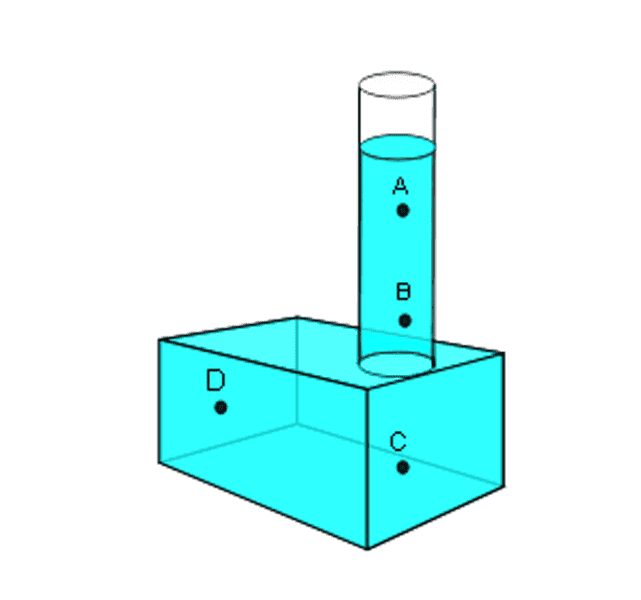

I think the key point you are missing in Pascal's Law ("the pressure is the same everywhere if the fluid is at rest") is this situation applies only in those cases where the fluid is confined.
For example, in your beaker scenario, I am presuming the beaker is open at the top. In that situation, after the beaker is filled, the pressure in the fluid at points A, B, and C will vary with depth from the free surface of the fluid. The pressure will not be the same unless A, B, and C are at the same depth relative to the surface of the fluid.
Now, instead of a beaker with an open top, suppose I had a beaker which was closed by a tight fitting piston, which was able to slide along the sides of the beaker without allowing any leakage. If I filled the space between the piston and the bottom of the beaker with a fluid, and then applied a force to the piston, the pressure at all points in the enclosed volume contained by the sides and bottom of the beaker and the piston would be equal. This is the mechanical principle behind hydraulic mechanisms.

It works out because same height = same depth. One is just measured from the bottom up, and the other is measured from the top down.
Mr. SteamKing,
In my attachment, Pressure at points C and D will be same and Point B will have more pressure than Point A. Points C and D will have more pressure than A and B. Am I right?
Instead of an open beaker, I fit a piston and compress the liquid. What will happen to pressure at these points?
I am interpreting in this way. Due to compression the point A will experience an increase in pressure, say 2 pascal, and at the same time point B will also experience an increase in pressure by 2 pascal. Points C and D will have the same pressure.
Correct me if i am wrong.
