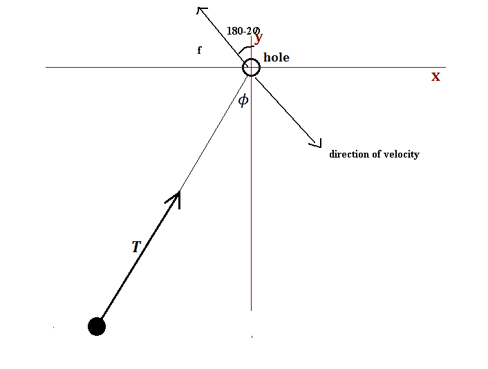

  • #62
OK, your directions look good. But it seems to me that the arrows you added should be drawn at the particle rather than the hole.
[EDIT: I noticed that you did not draw the direction of ##f## very accurately. Your value of ##180^o - 2\phi## is correct. But if you draw this angle more accurately, I think you will see that ##f## points in a different direction.]
So I think you have the correct angle for the direction of motion of the particle. Let ##r## be the length of the string between the particle and the hole. You want to find the path of the particle. In polar coordinates, this would be ##r## as a function ##\phi##.
Suppose the particle undergoes a small displacement ##ds##. Can you find expressions for ##dr## and ##d\phi## in terms of ##ds##, ##r##, and ##\phi##?

No. Can you show a diagram with the forces acting on the particle and also show the vector ##\vec{ds}##?
Note that in the figure, I made ##\phi## roughly 30o. So, what is the approximate value of ##180 - 2\phi## ? Make sure you draw ##f## approximately in this direction. Then draw ##\vec{ds}## in the appropriate direction.
[EDIT: Sorry, Vibhor, your values for the angles are correct! When I worked through this part of the problem, I did not use the unit vectors ##\hat{r}## and ##\hat{\phi}##. When I read your last thread, I had the vectors pictured in my head in their opposite directions.]

So, since you got the angles correct, your diagram hopefully looks something like this:

I got really discouraged reading your initial reply in #70 . But now I feel better :smile:
  • #74
##-dscos\phi = dr ##
##-dssin\phi = rd\phi ##
From this I get ##\frac{dr}{r} = \frac{d\phi}{tan\phi}##
  • #75
Great! The first two equations above can pretty much be read directly off the diagram. But using the unit vectors is good, too.
  • #76
Integrating I get ##r=Csin\phi ## , where ##C## is a constant .
  • #77
Yep.
