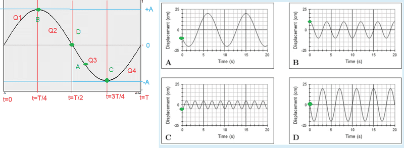

Asin(wt + Φ)
let t = 0
Case A:
-.10 = .20sin(Φ)
sin-1(-.10/.20) = Φ = -0.52
Case B:
.10 = .10sin(Φ)
sin-1(.10/.10) = Φ = 1.57Case C:
-.05 = .05sin(Φ)
sin-1(-.05/.05) = Φ = -1.57Case D:
0 = .20sin(Φ)
sin-1(0/.20) = Φ = 0
Now i think i have to determine which ones are in which quadrant. i have to determine whether to subtract pi or not. But how to determine?​

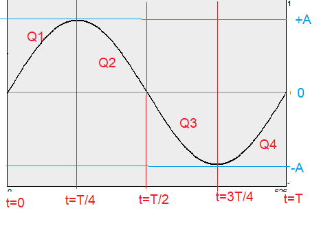

You can see from your graphs which quadrant they are in.
Since you use the sine function, A sin( ωt ), the first quadrant is the section that starts at 0 and rises to A, the second starts at A and falls to 0, the third starts at 0 and falls to -A, and the fourth starts at -A and rises to 0. Equally you can look at the time values: if T is the period, then first quadrant is from t=o to t=T/4, second from t=T/4 to T/2, etc.
Just look at the intercept on the displacement axis and see which part of the cycle it corresponds to.
So i ranked it as c < d < b < a
some of them i thought i would not have to add pi ( i made a mistake in op i think it is add pi) and this was incorrect. some of them are not in any quadrant so there is no no need to add. i added pi to a, and that seemed like the only one that needed it

Your original answers were: A= -π/6 , B=π/2, C= -π/2 and D= 0.
Looking at my diagram, two of these are not correct. What have you now said they are?
b and a were incorrect
not a actually a is correct

I disagree with a. (I'll leave the other error for now)
Your calculation sin-1(-.10/.20) = Φ = -0.52 gives one numerically possible result. There is another. You picked the wrong one.
You can see this from the graph -
I've put the origin in the centre and written the phase scale in decimal radians as you used.
You can see that your value of Φ = -0.52 does not correspond with the position of A.
There are two phase angles which give sin(Φ) = -0.5
One is Φ = -0.52 and its aliases 2πN - 0.52 (where N is an integer)
The other is where A is.
Another method you may have used to solve trig equations, implied by your term "quadrant" could be this diagram:
Where you can see that the other solution to Φ = sin-1(-0.5) is Φ = π + 0.52
