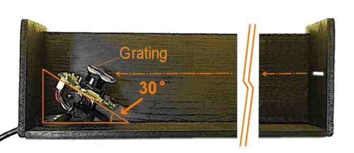

Why no diagram? Well, I thought the description was OK but I am happy to provide one below.
I really appreciate how you trod a careful line between giving me useful feedback on how to do better without being unkind - so thanks for that.
  • Diagram of a diffraction grating setup: a dark box with a grating mounted at 30 degrees, a webcam-like device, and dashed orange arrows labelled Grating and 30 degrees showing the light path, with a break in the box on the right.
Thanks for the picture. It would, perhaps have been better to post just a line diagram. It isn't at all clear what's what, in that mass of stuff which includes the camera. Is that a marked-up photo of y our actual setup?
If things are as I think you describe then, with autofocus (or at ∞), the camera is not actually looking at the fringes that you see on a screen. It's doing what your eyes do when they look through a dirty window at a house across the street; the stuff on the glass is out of focus and it will see a sort of virtual image of the collimating slot. That could be why altering the position of the camera is making no difference.
If you can remove the lens then you should get an image on the sensor, direct. I only have experience of a CMOS 'webcam style' for astrophotography which is mostly operated without the lens and you can unscrew it easily. However, the sensor will be tiny (probably around 10mm'ish) and you may only get a small part of the spectrum on it. You say you want good resolution so it may require a very narrow slot in the collimator. (The beam from your red pointer is probably actually quite wide (for good pointing to a audience). Experiment with different slot widths. Two razor blades or equivalent, held in a cardboard frame, perhaps, would allow for easy adjustment. The secret to solving this sort of problem is to experiment, experiment, experiment - and remember / write down results or you could forget which version of the setup actually worked best.
It is probably not necessary for me to mention the need to cover it all with a black sheet - to exclude extraneous light - sorry if it's telling my grandmother how to suck eggs.

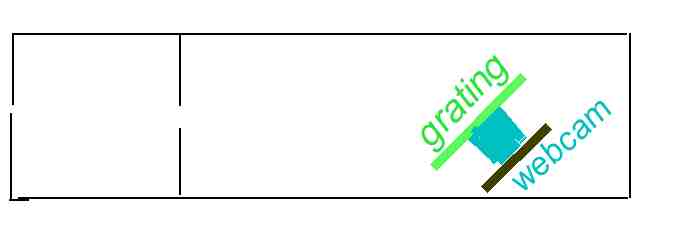

Thanks again Sophie. I've uploaded a diagram. The blue part is the lens barrel and the brown part is the PCB on which the CCD chip and ancilliary electronics are mounted. The camera lens is directly behind the grating - maybe 3mm from it. I don't understand your window analogy - the camera is not pointing axially, it is looking at the black interior of the tube. Without the grating it would see a black internal wall.
You drew my attention to CCD cersus CMOS. I've been using "CCD" but (gulp) been using the term informally to mean "sensor". I've actually no idea if it's CCD or CMOS. It's a cheap webcam and the spec just refers to the "sensor" not specifying the technology.
Removing the lens and imaging on the sensor directly is a fascinating prospec. This sensor is only 3mm across and 0 as you say - I don't think I could get a significant part of the spectrum on it. I've just tried to form an image by holding it manually in front of the grating but can't form any kind of image. I may try again with a more controlled support but, as well as the "won't fit" thing, this leaves the sensor open to the air which might be unwise.
My understanding of the way a greating works is that the incident beam width doesn't matter - the more slits in use the better the contrast and resolution beucause of more destructive interference, but from what you're saying that's wrong. Maybe it's only true for a monochromatic source. This spectrometer has a 1mm slit ans is currently giving about 1nm resolution; I'm just trying to make it better.
Don't worry about condescending - I recognise I'm the underling here and happy to learn.
My experiments are grim because I'm propping things up with bluetac and weights, and things are moving and drooping out of alignment - I need an optical bench. But it IS crystal clear now that the camera/grating distance does not affect the spectrum image size which is why I posted. Only tilting the grating with respect to the camera stretches the spectrum. Since that's the only paramter I can see that's available that works, I think I will make a custom frame with a large angle and see if it will calibrate correctly or is a software change would be needed. Unless you have other ideas?
Thanks again.
  • Diagram of a camera setup: a long rectangular tube with a vertical slit near the left end, a green diffraction grating angled inside, and a teal lens barrel behind it with a dark brown PCB labelled webcam.

Tilting the lens/camera axis will only lead to distortion of the image. You might fill more of the focal plane array, but it is almost guaranteed that this will not improve the resolution. One thing that might help is to view the spectrum at order ##m=2 ##.
OK thanks again Charles.
