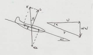

An example of power, velocity and force with constant velocity/zero acceleration is in the case of a glider moving at constant velocity. The force of drag times velocity is the power of the glider; i.e. power=drag*airspeed... Of course, in this case, the energy of the glider comes from the variation of potential energy, as the glider loses altitude... Also, power=weight of the glider*vertical velocity... The drawing shows the forces and the speeds U,V, WW...
