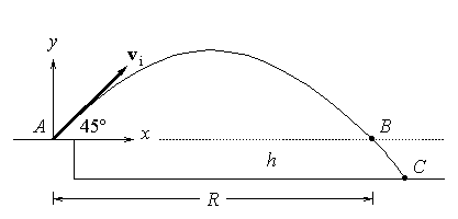

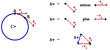

I want a software by which such diagrams can be created.Samples are given below.
Some more samples are given.
I've done more complicated drawings than those for journal publications, all using Powerpoint! I have also used Visio, which has many built-in 'stencils'.
You don't need anything more involved if most of your figures are blocks, lines, and simple curves.
