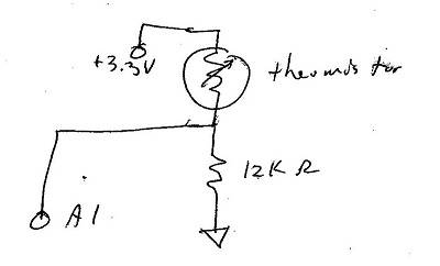

Example 1: Temperature measurement. A sketch that I made at the time for a particular thermistor is shown below. The resistor value is chosen to make the voltage vs temperature curve as linear as possible. Study materials include thermistor response curves, thermistor response time constant, A/D resolution, supply voltage regulation.

Example 3: Sensor impedance. I learned the hard way that any sensor must have input impedance less than 30K ohms. Thermistor and strain gauge circuits almost always meet this spec, but I was trying to measure battery voltage with a resistor voltage divider with resistance too large in order to minimize power consumption. This is actually a good place to start. Measure your battery voltage using a separate voltage divider and output the results. Are the readings sensitive to ambient temperatures?
