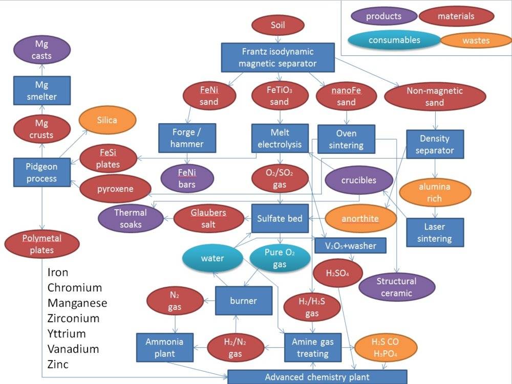

I am evaluating the possibility what magnesium may be the most-easily obtainable structural material on Moon.
The following ISRU sequence is proposed:
1) Regolith melt electrolysis produce ingots made of ferro-silicon, as by-product of breathable oxygen production
2) Ferro-silicon ingots are crushed and mixed with magnesium-rich crushed rocks
3) The mix is heated to ~1150C in ceramic or steel vessel to release magnesium vapour, similar to Pidgeon process
I invite the comments and proposal on following topics:
1) Suitability of Moon rocks for the Pidgeon process (seems major constituents are all compatible with process, although i have doubts regarding minor components like sodium, titanium or chromium which may result in unwanted by-products)
2) On Earth, Pidgeon process is evolving to high-pressure, high-temperature variants. Is it different for the conditions on the Moon?
3) Plausible magnesium alloying with Moon feed-stocks to improve alloy properties?
4) General comments and suggestions on the image of the ISRU scheme attached to this post?
  • Flowchart of a lunar resource processing scheme with blue process boxes, red material ovals, purple product ovals, teal consumable ovals and orange waste ovals. Soil feeds a Frantz magnetic separator, then melt electrolysis, then Pidgeon process to Mg crusts, Mg smelter and Mg casts.

The seemingly abandoned 'FeNi sand' line of products might be able to challenge the 'most-easily obtainable' claim based on energy requirement.
While the amount of soil to be moved might be more, the energy requirement might be still lower since there is just one heating and no electrolysis in the process.
But to spice up things you can try throwing some metal powder based 3D printing into the pot too.
I have a doubts about FeNi sand availability and energy intensity of smelting. The typical concentration of FeNi of meteorite origin in lunar soil is about 0.04%-0.2%, and most of it may be heavily agglutinated with the rock material. Separation (by hammering/forging and magnetic separation) may be energy intensive, and smelting itself is at 1500C, while 1150C required for magnesium production and 700C for magnesium smelting.
I must point out what rock melt electrolysis step in magnesium production chain is likely should be done anyway for breathable oxygen production, resulting in energy spent for electrolysis irrelevant to structural material production expenditure. Of course, rock melt electrolysis machine may be useless for unmanned base, in this case argument for the FeNi is true.
