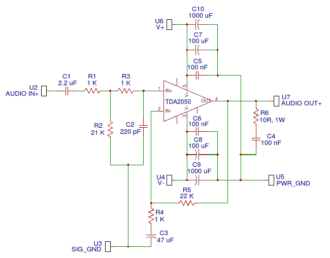

hello
please can somebody help me
i am a begginer
i understeand everything
just decoupling capacitor, i don't know te value how to select , of how to calculate
C10, C7, C5
thanks
The capacitor values are marked on your diagram so what do you need to know?
hi Manolis,
i did not put me the value of components, but i find in the internet the circuit(searching for TDA2050, i need for audtio amplifier(i have chip TDA2050),
and i know all other component value to calculate, but only DECOUPLING capacitor i don't know,
because Manolis i am beginner, i hope you understand me.
thnx

The value of the decoupling capacitor doesn't matter. What matters is its effective impedance at various frequencies - low to high. The 3 capacitors are chosen to provide a low impedance across the range of frequencies to prevent oscillation.
It is good that you will be building it. Hopefully you are doing a prototype before a PCB. During the prototype build, use those values as a starting point. You got those values from somewhere so perhaps you have specific capacitor part numbers to work with. Make sure the voltage rating of the capacitor can handle the voltage rails. When you have your prototype built, evaluate it. If you are happy with it, you could be done. If you want to learn about the effects of your capacitor selection, experiment by removing them, adding them back one at a time, etc.

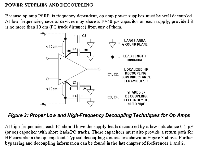

The basic idea of decoupling is to keep the power supply voltage stable when the amplifier takes a sudden gulp of current.
If the power supply voltage changes , it will affect the amplifier's output slightly. By how much is indicated by the amplifier's "Power Supply rejection Ratio" .
That is given in the datasheet, at http://www.st.com/content/ccc/resou...df/jcr:content/translations/en.CD00000131.pdf
page 3
as only 45 db@100 hz.
Since the amplifier has feedback, that change in output will get coupled around to the input
and when phase shift becomes 180 degrees what was intended as negative feedback becomes positive and it'll oscillate.
Power supply rejection typically becomes less as frequency increases so it's important to have steady voltage right at the amplifier pins.See this application note
http://www.analog.com/media/en/training-seminars/tutorials/MT-043.pdf
Since each type of device has its own gain, frequency response, and power supply rejection ratio , selection of decoupling capacitors is best left to the designer of the device. He will give you his suggested values. Here's what he put in the TDA2050 datasheet for you to use.
It is important they be located physically close to the amplifier pins so as to minimize inductance of the interconnecting wires.That Analog Devices tutorial makes it clear why you need both a low frequency and a high frequency bypass capacitor. That's C10 and C5 (and C6 & C9) in your example.
I don't know what is the purpose of the 100 uf C7 in your example.
And that's the best answer i can give.

Interesting,
in your example schematic they drew the high frequency decoupling capacitor closest to the pins , as it should be physically. That's good draftsmanship.
