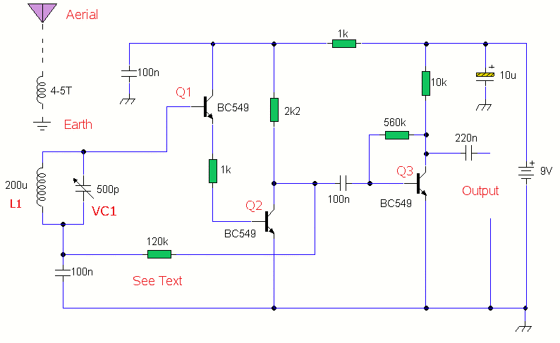

hello, can somebody help me? i found this am receiver, but is using variable capacitor, how can i replace of do with varicap this circuits(i hava varicap bb112)
Schematic of a transistor AM radio front end with aerial, tuned coil L1 200u, variable capacitor VC1 500p, transistors Q1, Q2 and Q3 labelled BC549, 9V supply and an output node.
  • Schematic of a transistor AM radio front end with aerial, tuned coil L1 200u, variable capacitor VC1 500p, transistors Q1, Q2 and Q3 labelled BC549, 9V supply and an output node.

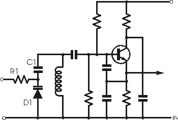

The varicap is voltage driven, so you must isolate it with a 1nF capacitor at each end. Or - bring one end of the varicap to ground like this:
Circuit schematic of a transistor oscillator stage with a varicap diode D1 in series with capacitor C1, resistor R1 and an inductor, feeding a transistor amplifier with resistors, coupling capacitors and a 0V ground rail.
  • Circuit schematic of a transistor oscillator stage with a varicap diode D1 in series with capacitor C1, resistor R1 and an inductor, feeding a transistor amplifier with resistors, coupling capacitors and a 0V ground rail.

As for the antenna, use the same connection as in the original diagram. It is shown as inductively coupled to the tuning coil by the 4-5 t winding.

A minor difficulty with that circuit is the floating voltage of the tuned circuit secondary.
If it is to use a varicap, controlled by a DC voltage, it will need to be referenced to ground.
But there is an envelope detector embedded in that circuit, which must not be broken by the change in front end bias.
That might explain why the input RF transformer has a floating tuned secondary.
The supply voltage is 9V, the varicap will need most of that. The control voltage pot needs a regulated voltage.
Without regulation, any change in battery voltage due to audio output load will de-tune the RF circuit.
The pot and regulator will use more current. So power consumption will rise with the change to a varicap.

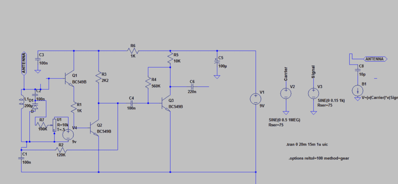

LTspice schematic of a transistor radio front end with antenna input, tuned LC network, two BC549B transistors, 9V supply, carrier and signal sine sources, and simulation directives .tran 0 20m 15m 1u uic and .options reltol=100 method=gear.
  • LTspice schematic of a transistor radio front end with antenna input, tuned LC network, two BC549B transistors, 9V supply, carrier and signal sine sources, and simulation directives .tran 0 20m 15m 1u uic and .options reltol=100 method=gear.

yes me too, but i connect without antenna i hear noise
michael1978 said:
No this was orginal circuits so i replace varicap bb112, but i hear only noise
@michael1978. That looks like LTspice. Have you been successful running that simulation ?
There are some obvious problems, it is easier to edit your file than create another.
Can you please attach your file.asc to a post with the txt extension as file.asc.txt
Attach the plot file in the same way if the simulation worked. file.plt.txt

yes i send you, if you can help me... I RENAME am.asc into am.txt

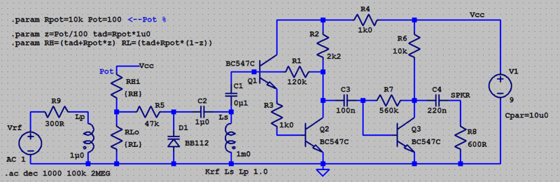

Here is a modified bias circuit, no model for BB112 or Pot, but circuit should work.
LTspice schematic of a varicap-tuned circuit with a BC547C transistor stage, two more BC547C stages, diode BB112, a potentiometer-driven bias network, and a tuned input from AC source Vrf through Lp.
C1 and C2 must be low leakage caps. Avoid power supply bypass caps.
  • New_1.asc.txt

thank you very much, but i have just 2 more question, why you pick 47K to potentiometer, normally they say a few megaohms, and last where to connect antenna and i need simple inductor 200u ? and that was only for test trnsformer thanks
1. The resistor needs to be big to keep the Q of the LC circuit high. Any coupling capacitor or varicap reverse leakage current will flow through the resistor, so I use 47k as a starting value. Any resistor over 100k is likely to leak due to environmental contamination.
2. For MW reception I would wind 75 turns on a ferrite rod and use that for the tuning inductor and the antenna. No external antenna is needed.
You could experiment with 50 turns of wire on a 2" or 50mm plastic pipe or cardboard roll. Wind a temporary primary of 12 turns over the coil to couple an external antenna.

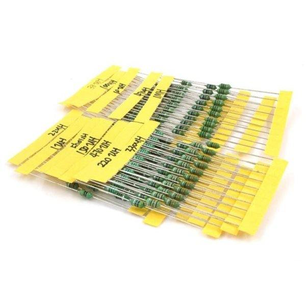

sorry you misundestand me, i have a inductor(i don't know how they call? they look like resistor, but they are inductor)

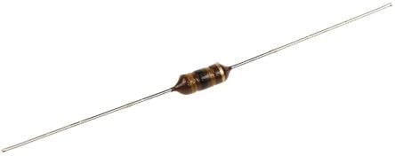

I have those inductor, thay work of not with this inductor?
OK, got that cleared up :smile:
I will say no, you need to go with what Baluncore was telling you in post #22
If you use a two terminal axial inductor, how will you connect the antenna?
The antenna connects to the primary of the RF transformer, the secondary is tuned to resonance with a capacitor.
I don't know whether these inductors would work in this tuned circuit, but since he has them he could try it out. I would expect to be able to couple to it with an overwinding of a few turns, just as in the original circuit.
