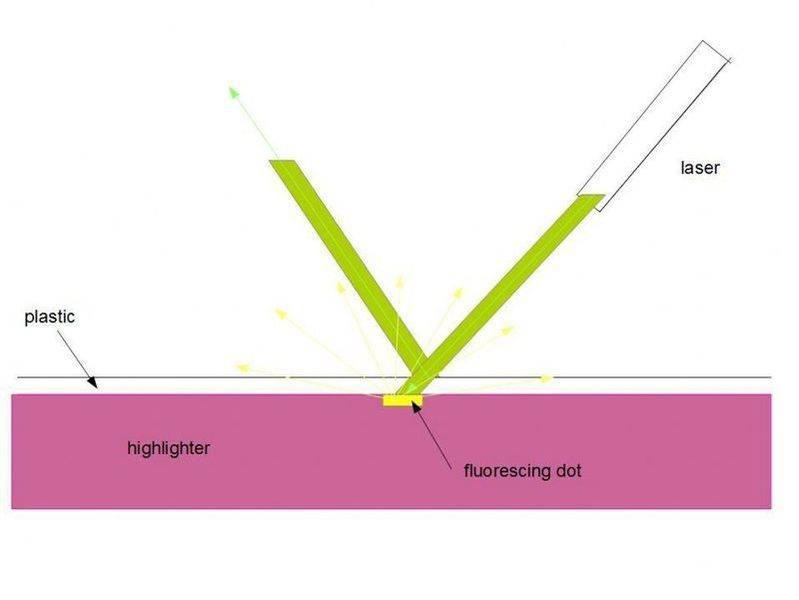

I assume it happens like this:
EDIT: I edited it so often that some parts don't make much sense anymore.

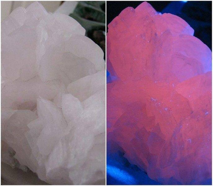

I use UV fluorescence to identify mineral samples.
the white light colour of the minerals can be VERY different to the colour of the emitted light during exposure to
UV light. Whites can be reds or greens under UV light. Similar things may be happening in the OP's case
here's an example of calcite ...

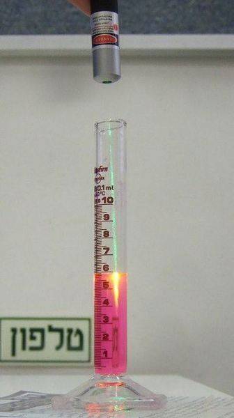

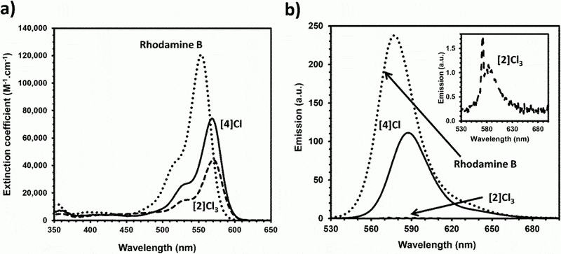

A photograph of a green laser illuminating rhodamine B and seeming to produce yellow light.
and graphs of Rhodamine B absorption and emmission
These are all in solution, so may not match the solid film effects, but it shows a suitable shift is plausible.

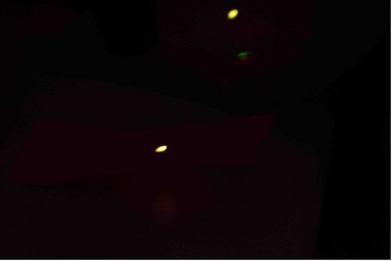

And i was right. When I pointed the laser at a sheet of "pink highlighter" colored notepaper it also looked yellow.
But its reflection in a cd had "green-red" diffraction patterns.
I know it looks like a photographed this picture with a potato but the real reason is that the picture did not take the compressing very well.
The colors got all messed up... And photographing it was kind of hard. I only have so many hands.

Very interesting. It could be a good research project for someone who has a spectrometer available. A spectrometer (diffraction grating type) will sort out the colors better than the human eye that can easily misinterpret a color, especially when more than one color is present.
I did bounced the laser from the paper I painted it and got similar patterns, in my photo orange is overexposed by the camera.

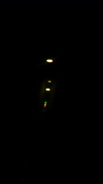

I got nearly the same results with pointing laser to body of the marker and even to the cap alone. In these cases I observed a spectrum of red,orange, yellow and green . But most vivid orange I get is by pointing laser directly to the tip of the marker.
I tried an orange marker and I got greenish yellow and on a green highlighter I didn't see any color change.
However if it's a wavelength shift what are the red and green colors on cd? If it's not a hue shift why it happens on florescents only? Cause I tried a different marker with nearly the same color and also mixed oil paints really close to the pink one but both were failure, only green reflections.
I have other florescent objects, toys and nail polishes maybe I try them later.
