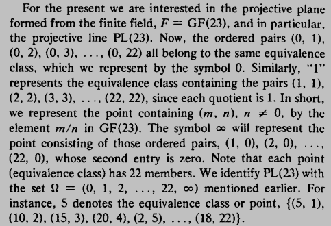

I found in Thompson "From Error-Correcting to Sphere Packing and Simple Groups" this on page 131
How do you compute m/n in a finite field?
Take the equivalence class 5 given above. Why does 2/5 and 18/22 give 5?
thanks
The finite field being used is ##GF(23)## which is (isomorphic to) the set of integers modulo 23. Because 23 is prime, that is a field.
2/5=5 because ##5\times 5=25=2\mod 23##
18/22=5 because ##5\times 22=110=18\mod 23##
