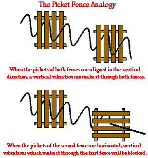

Polarization is, in a simple sense, the limiting of photon vibrations to one vibrational plane. Photons can vibrate in a horizontal plane as well as a vertical plane. In order to understand this better, take the "picket fence analogy:"
If the picket fence is lined horizontally, then only light vibrating in the horizontal plane will be able to cross through. Polarization decreases the amount of light that goes through. The frequency of the light that is polarized will remain the same, the only thing that will change is the alignment of vibration.

Unfortunately, the 'picket fence' analogy can be very misleading. It has to be presented very well if it is not to be taken wrongly. It always has to be stressed that the slots are not just 'selective' (only letting certain waves through) but they take one vector component of all waves that arrive. If the fence is merely 'selective' then it will only let an infinitesimally small fraction of the energy through as opposed to half the energy which is what we find with real polarisers.
The pictures in the above post are not good, in this respect; the bottom picture really does suggest that none of the slightly tilted wave would get through.
Also, there is no point in talking of "photons vibrating" in a particular direction. If this were a proper model then a polariser would be taking a fraction of the energy of any photon that is not perfectly aligned with the polariser's plane. We all know that photons have an energy value that is determined by the frequency so how could we only have a fraction of this energy? Why oh why do people seem to think that photons help in these arguments? It just shoots any explanation in the foot. (Even that picket fence argument manages to avoid photons - that is one small thing in its favour)

So the picket fence analogies are entirely useless?
I don't think the centaur said useless, the message was "misleading --- handle with care", which is a good message
EDIT: I think that as an explicitly non-technical ANALOGY, it is a helpful explanation for non-technical people.

Possibly but you have to expect probelms down the line. You could ask what do they want to know for if the analogy is either a poor one or needs loads of qualifications. When asked about polarisation, I always refer to TV antenna on peoples' roofs. They all recognise one and they also seem to grasp very quickly how the signal out varies as the orientation of the antenna is moved through a complete turn. It's a short step to move into light polarisation. No fudges involved there, I think and nothing they are going to need to 'un-learn' later. They even get the fact that exact cross polarisation cancellation is very hard to achieve and you don't need to mention the word 'vector'.
