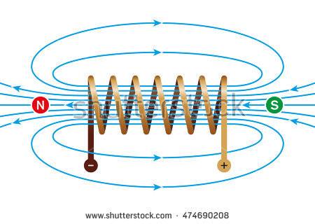

Good. Depending on the construction technique used in the inductor, there can be some of the internal magnetic field that leaks out and can couple to nearby inductors. So when using multiple inductors in a circuit, the spacing and orientations can be very important (to get the inductances you want). You can use shielded inductors, but they are more expensive than their unshielded versions.
When you have to place 2 inductors close to each other, often it's a good idea to orient them at right angles to each other. Can you say why this may help to mitigate the parasitic B-field coupling between them?

Well... I can visualize it, and the two inductors would then be perpendicular to each other, so I would assume the fields have less interference, and perhaps it's something to do with the interaction of the poles when they are at right angles, I'm just trying to think here without looking it up, I know when two fields interact, the top field is stronger than the one below it... so perhaps when they are at right angles, the field of the horizontal facing inductor will have a lesser effect, as the two fields are moving in the same direction above perhaps...
It's mainly that the B-field from each inductor pierces the other inductor at mostly a right angle, and what doesn't go through at a right angle cancels out, so there is no net coupling from one coil to the other. If they are in the shape of a "T", then half of the B-field from the bottom inductor goes one way through the top coil, and the other half of the B-field goes the other way through the top coil. :smile:
