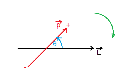

The sign error is caused by the controversial signs of the angle and torque.
Diagram of an electric dipole moment p pointing up and to the right at angle θ from a horizontal electric field E pointing right, with a green clockwise arrow at upper right.
You see that the torque of the electric field causes decreasing angle, clockwise (negative) direction of rotation of the dipole. So τ(field) = -p x E.
But isn't it only in the work integral that it becomes a - wrt +dθ? because Wfield=∫τfielddθcos π?
What do you mean?
The electric field tends to align the dipole, decreasing the angle θ. The "natural" processes tend to make the potential energy minimum. If we set the zero of the potential energy at angle θ=pi/2, the potential energy is negative at θ=0.

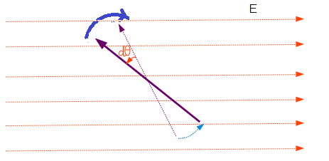

Diagram of a dipole in a uniform electric field: horizontal red arrows point right and are labelled E, a bold violet arrow shows the dipole moment p tilted to the left, with blue curved arrows and an angle theta marked between p and a dotted line.
τapp is -p x E will mean that it points out of the plane in this figure right? But how can that be? How do I derive potential energy in this scenario? the violet arrow is the dipole moment vector p. :cry: I know I am missing something big but i am not able to figure out why..

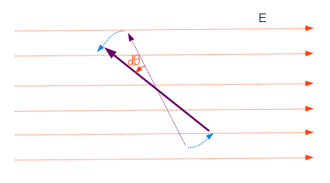

Diagram of an electric dipole at an angle to a uniform electric field of horizontal arrows pointing right, with the field labeled E; a dark purple arrow shows the dipole and blue curved arrows show rotation.
The electric field turns the dipole in the opposite direction as in your figure, clockwise. So the torque points into the plane. Calculate the potential energy as you did in the first post, only the sign of torque was wrong.
Diagram of an electric dipole in a uniform electric field: horizontal red arrows pointing right show the field E, and a purple arrow shows the dipole tilted at angle dθ, with curved blue arrows indicating rotation.
Then i'd be getting the work done by the field right? I am trying to get work done by external agent in turning the dipole as in the figure in my previous post.. The turning i indicated was that produced by external torque..this work is stored in the system right?

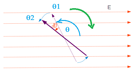

Diagram of a dipole in a uniform electric field: horizontal red arrows point right, a purple dipole arrow sits at an angle, with angles theta1, theta2 and theta marked and a green clockwise arrow indicating rotation.
The electric field tends to rotate the dipole in the direction of the green arrow, clockwise, to make it aligned with the field. To move the dipole by the red angle dθ, the external agent has to exert a torque, which would rotate the dipole in anti-clockwise direction, according to the thin blue arrows. The initial angle of the dipole with respect to the electric field is shown by the blue angle.
The elementary work of the external agent is dW=PEsin(θ)dθ, positive, as the displacement and force have the same sign. ( Both the angular displacement and the torque are positive). The work between θ1 and θ2 is equal to the potential difference U(θ2)-U(θ1) = -PE(cos(θ2)-cos(θ1)). If θ1=0 and θ2=pi/2, U(π/2)-U(0) = -PE(cos(π/2)-cos(0)). What is U(0) if U(π/2)=0?
