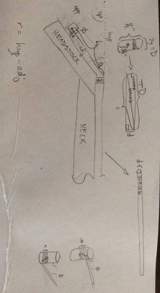

I have put together an equation whose purpose is:
With a desired 'magnitude of static friction' ( μ_s ), 'fundamental frequency' ( f ), and 'tension' ( T ),
initial conditions such as 'string breakover angle' ( Θ_0 ), 'nut-tuner distance' ( L_{h,0} ), and 'string diameter' ( d ),

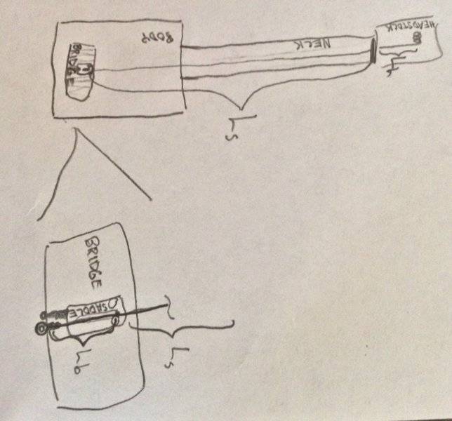

and, finally, constants 'tuner diameter' ( D ), 'nut thickness' ( L_n ), 'nut-saddle distance' ( L_s ), 'saddle-bridge distance' ( L_b ), 'elastic modulus' ( E ), and 'Poisson's Ratio' ( ν ),
What 'initial length of string' ( L_0 ) is required?
I have already written my work out, and was hoping there'd be someone among the members of PF who wouldn't mind helping to check it with me.
Please keep in mind that I am an undergraduate pursuing a degree in Music Education, studying percussion, and have a great passion for Physics and Math, applying what I learn to further accelerate my comprehension and make the execution of a piece of music that much more fluid and efficient.

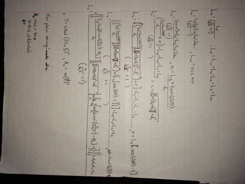

Handwritten derivation on lined paper, rotated sideways, of a formula for initial string length L_0 built from nested fractions, tan and sec terms, and definitions of L_h, n, c, r and delta theta.
(My apologies about the picture- I tried a few times to get it to display right side up, but it wouldn't work for me...)
As for the variables I have not yet explained, they have to do with geometries of the guitar, such as L_w , which is the length of extra string as it relates to windings around the string post, either up or down, where 'n' is the number of windings, 'c' is the length of string needed to circumscribe the string post once such that multiple windings will result in a diagonal sort of stack (like in reality), 'r' is the length associated with how L_h changes as more string is wrapped around the string post, and 'ΔΘ' has to do with how the breakover angle of the string from the nut to the tuner changes as more string is wrapped around the string post.
Note: The only flaw with 'r' as it is currently written is that it assumes the initial incident angle between the string and the string post is a right angle, and while this may be true for some cases I would like to be able to account for the majority of cases where this is not true.

With guitars where the headstock is angled using a scarf joint, the typical value of 'Θ_0', so I've read, is \frac{π}{12}. For the sake of argument, let's say the scale length 'L_s' is 25.5 in., the initial string diameter 'd' is 0.009 in., the string post is a solid cylinder (no concave milling) with a diameter 'D' of 0.25 in., sticks up out of the headstock by 0.5 in. and the hole for the string is halfway (0.25 in.) up, the initial nut-tuner distance 'L_h' is 6 in. (The high-e string of a guitar with a reversed headstock), and the saddle-bridge distance 'L_b' is 1.5 in. (no spring-loaded "tremolo" unit). Also, let's suppose that the nut is made of Teflon (ex. GraphTech TUSQ nut) so the coefficient of static friction 'μ_s' is about 0.04 .
Could you put up pictures of an actual guitar with the construction you describe or better still a technical drawing ?
